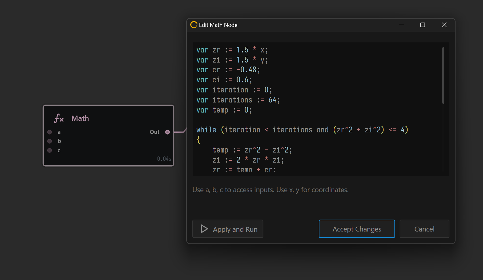

The Math node is a deceptively powerful node with a very simple interface. It is essentially a blank canvas for you to create any kind of mathematical functions or even complex algorithms.
The Math node can work standalone as a Generator, but can also accept up to 3 inputs. These inputs can be accessed as a,b,c respectively. Note, those are pre-defined variables and can't be used for any other purposes except to access data from the port.
You can also access coordinates per-pixel using x and y .
