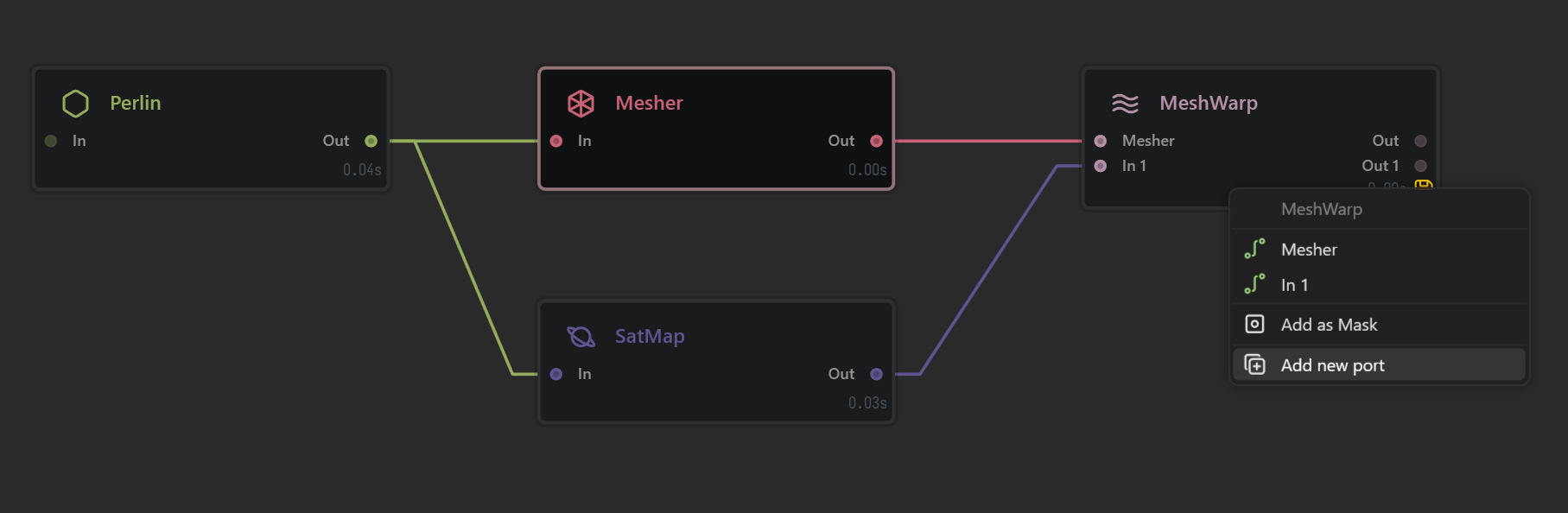

Warping Texture Maps and Masks
The MeshWarp node, along with generating tangent-space normals, will also apply nuanced warping to mask and color maps to make them fit the exported Mesh and LODs with a higher level of fidelity.
.png)
Drag and drop a connection on the MeshWarp node and select "Add new port" to add additional ports.

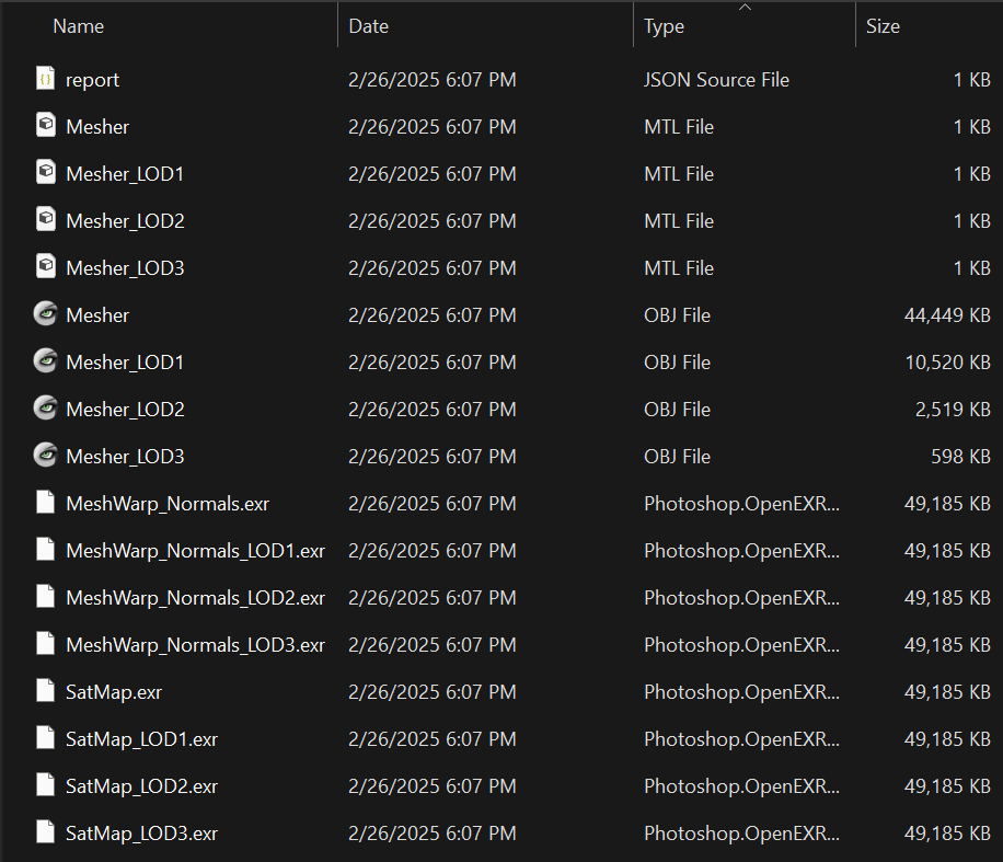

LOD Export
If your Mesher node has LODS set, then MeshWarp will generate appropriately warped versions of your connected maps for each LOD.
.png)
MeshWarp will use the incoming node's Name as the prefix for the file. So if you have a node PerlinMaskRocks then the output will be PerlinMaskRocks_LOD1 while the high-resolution version has no suffix.
It is also recommended that the previous node (PerlinMaskRocks, in this example) not be marked for Export as there may be file conflicts between the two as they save to the same name for the high-res version.
