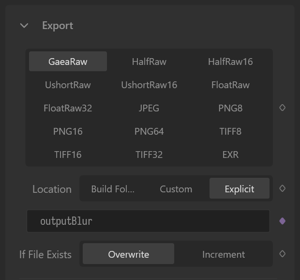

For Output, create a variable and set the Type to Output. Create an Export node, set the format to GaeaRaw, the Location to Explicit and bind the Output Path to your variable.

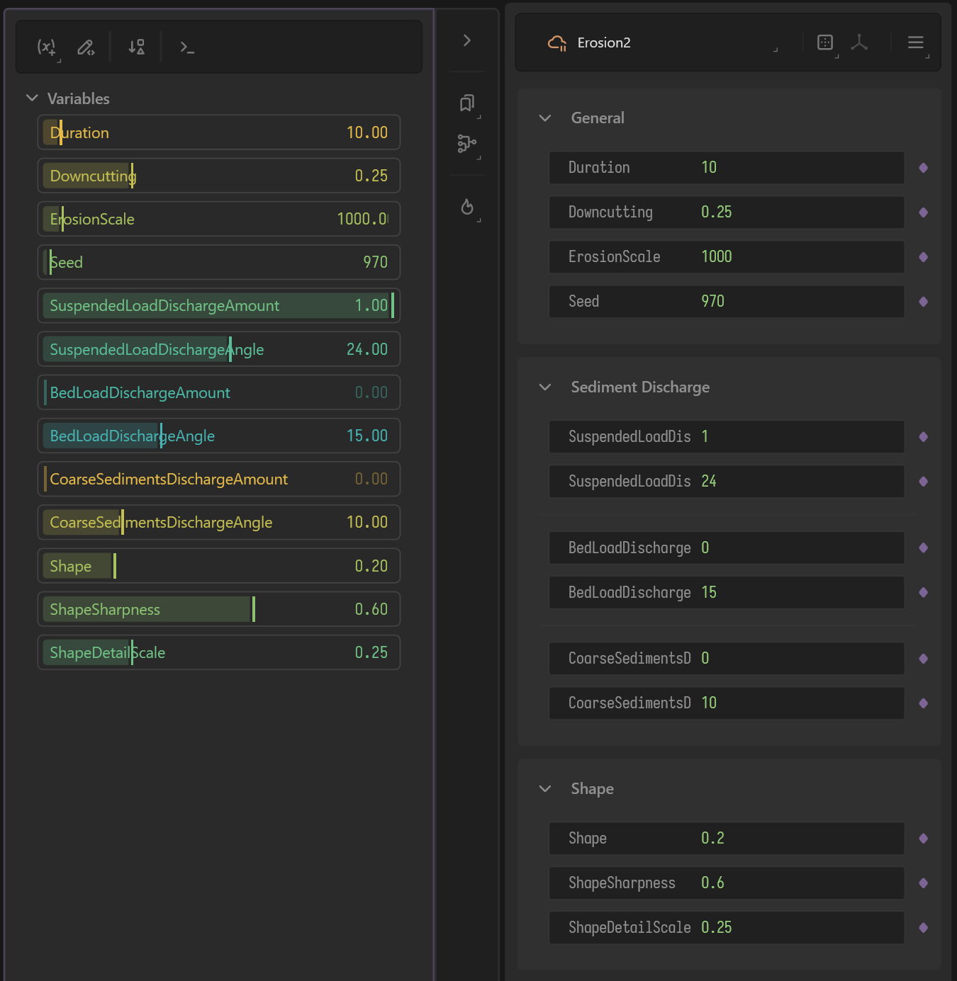

Let's say you only want to use Erosion2, create an Erosion2 node between the File and Export nodes.

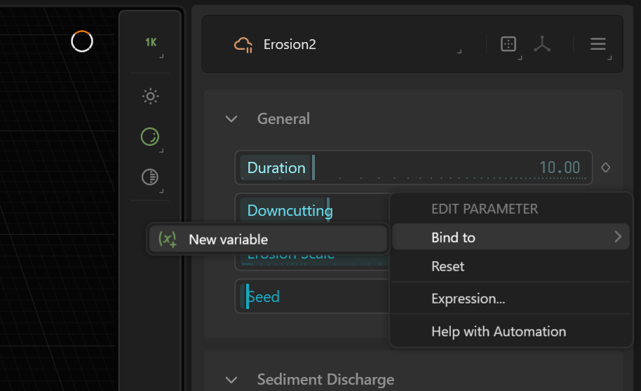

For each parameter you wish to expose, open the Edit Parameter menu and select Bind To > New Variable.
Once all your properties are exposed, your .terrain file is ready for use in Houdini.

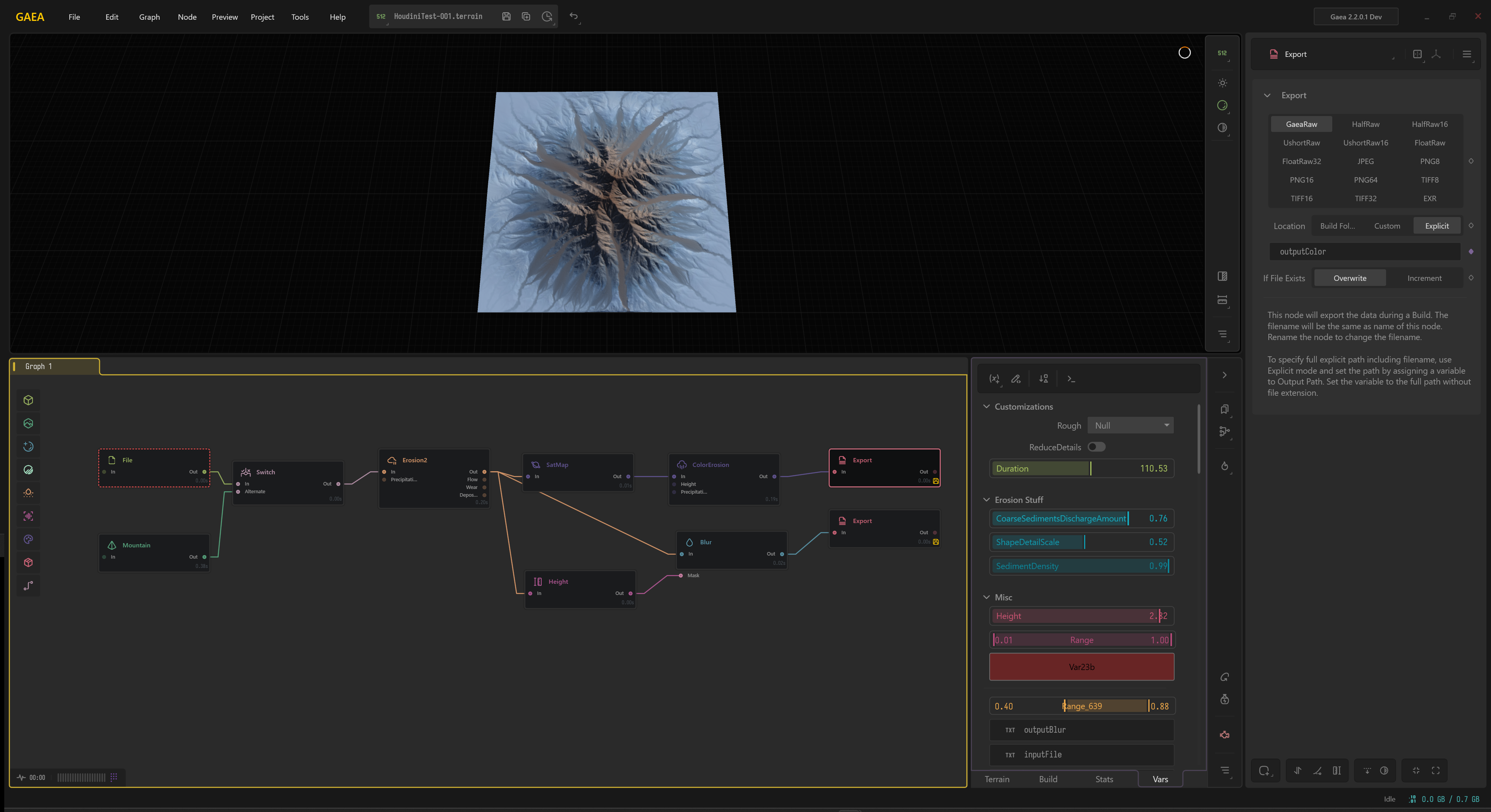

In this larger example, we have created two outputs - one for the heightfield and one for color, so we can use Gaea's ColorErosion tools.
