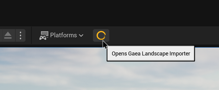

Once you have installed the Gaea2Unreal plugin in your UE installation, you will see the Gaea Landscape Importer in the main toolbar in Unreal Engine.

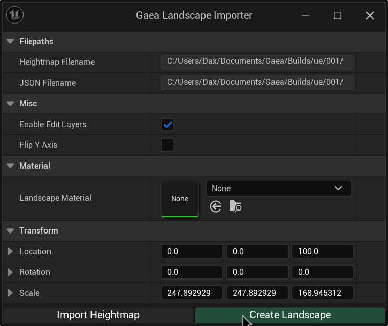

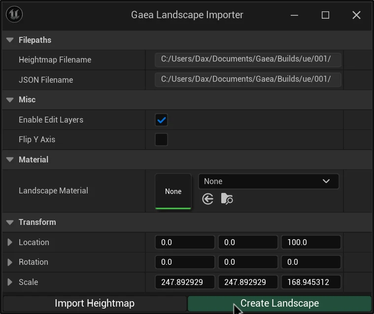

Clicking it will bring up the Gaea Landscape Importer window. Click Import Heightmap and select the PNG file that was exported from Gaea. The Importer will read the heightmap file along with the metadata saved by Gaea for UE-scale conversion, and populate the specifics in the window.

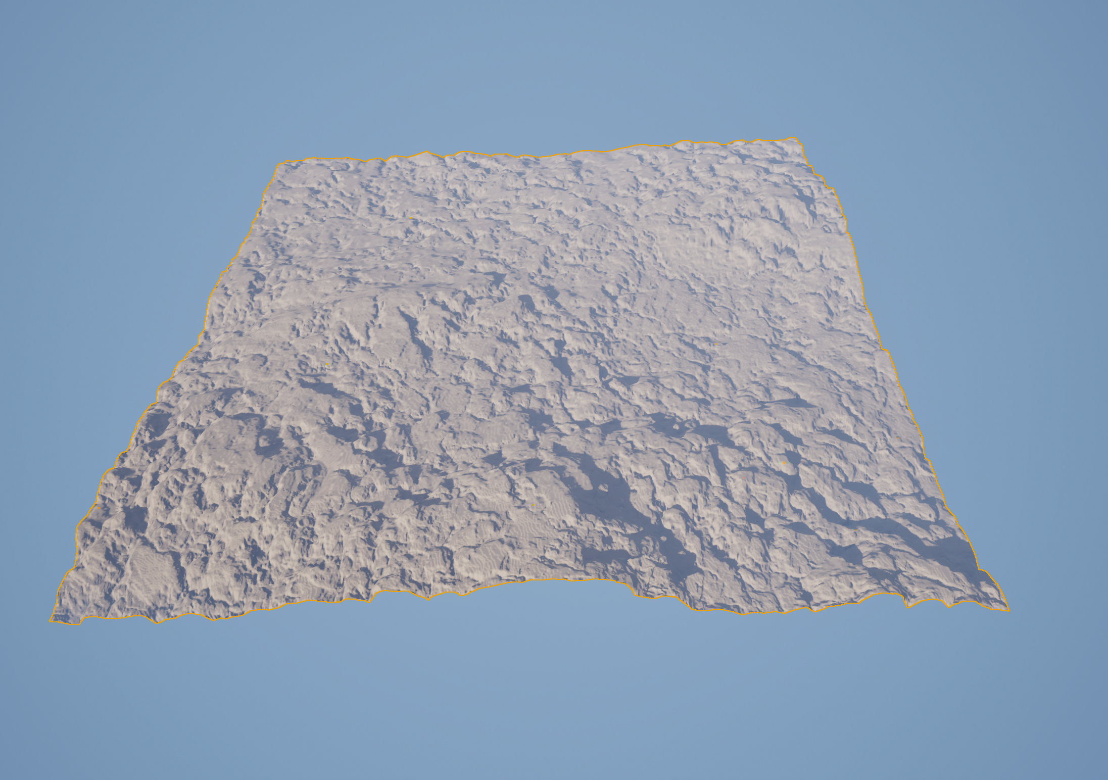

Click Create Landscape and you're done!
