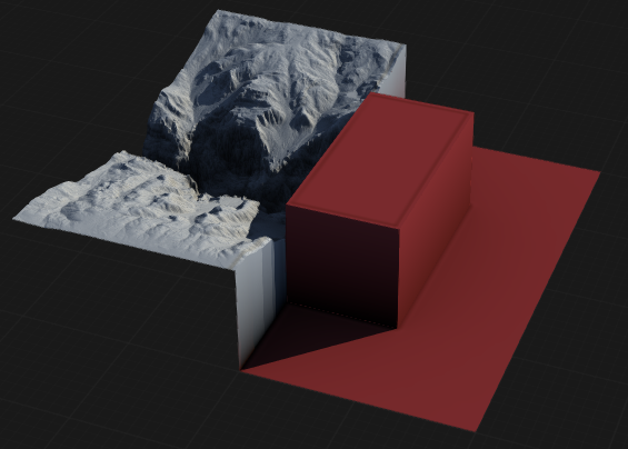

Matches the height range or histogram of one terrain to another.
Official Video
For a video breakdown of this node, see the official Match video.
The Match node is a low-level lets you provide a Reference input that is used to adapt/match the heights of the main Input.
This is useful when you need terrains to be a precise height, but lose some heights after a particular effect, erosion, or other processes.
See Match or Correct Heights for a practical example of how Match can be utilized.
Use Match when one terrain needs to inherit the height range or elevation character of a reference input.
Match
ModeSpecifies the method used to match the height of the current terrain to a reference terrain. Determines how the height adjustment is performed.
HeightDirectly matches the height values of the current terrain to the reference terrain, aligning elevation point-for-point. HistogramMatches the height distribution (histogram) of the current terrain to that of the reference terrain, preserving relative features while adjusting overall elevation statistics.
