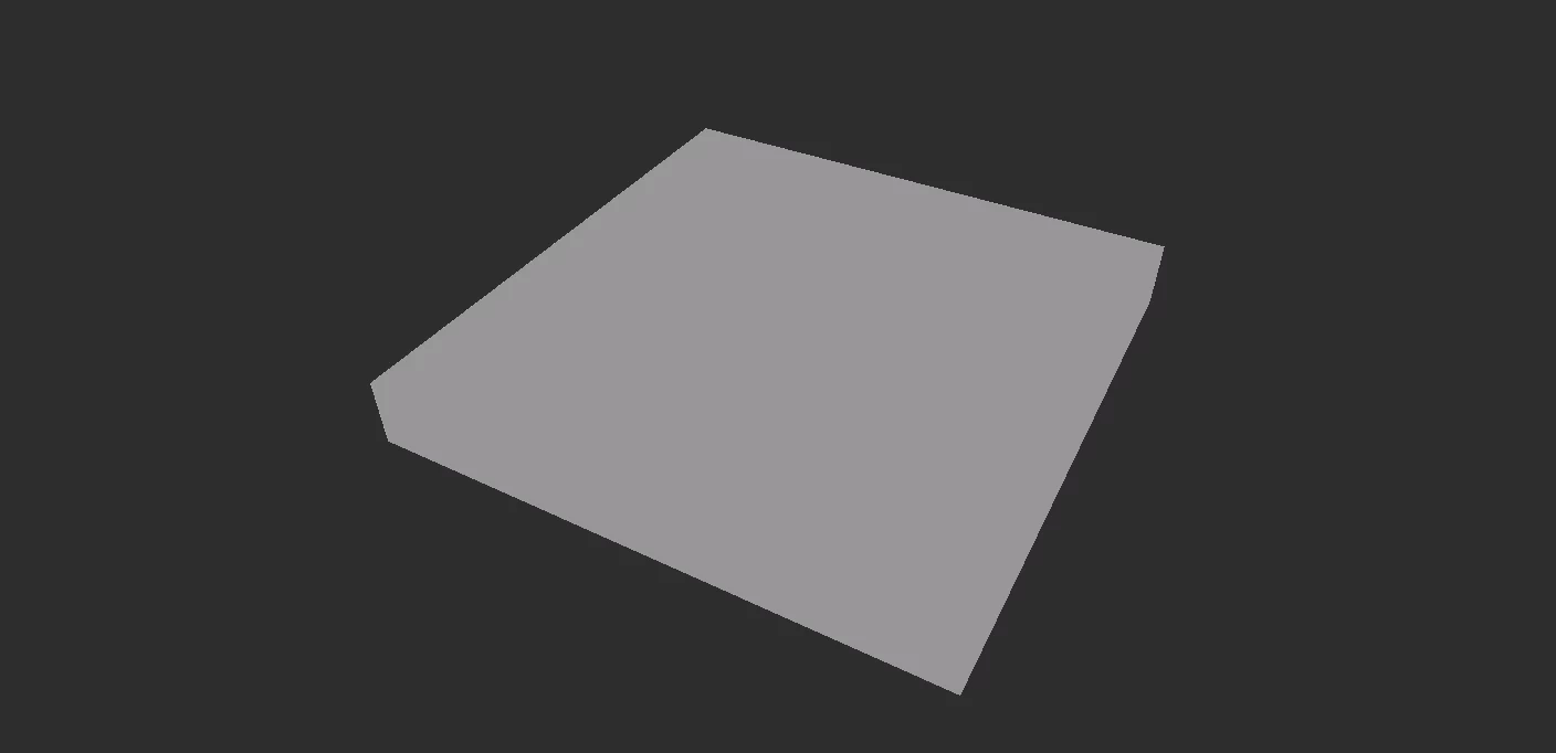

Height
The uniform height "block" terrain can be used with Combine in Max mode to create a flat area at the specified height in a terrain.
