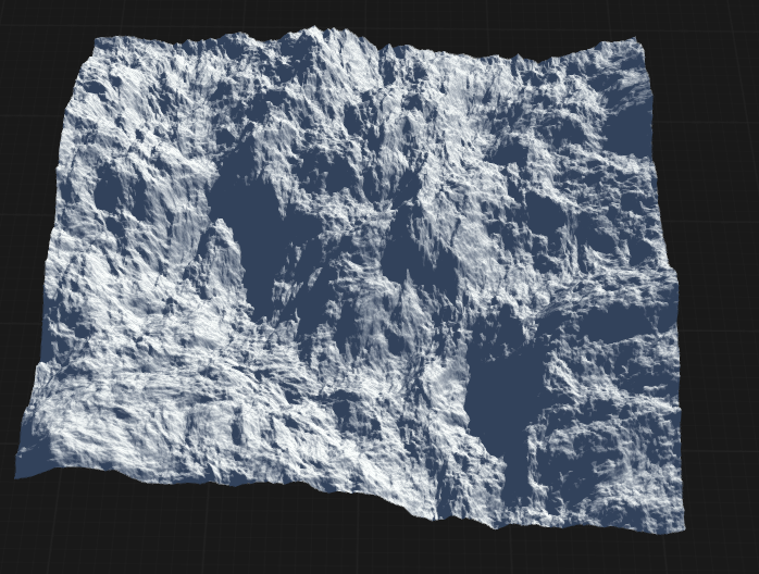

Use Perlin when you need a dependable all-purpose base noise for blocking out terrain, testing erosion, or blending with other primitives.
