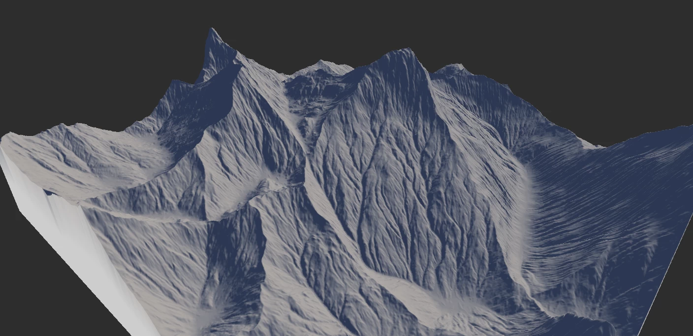

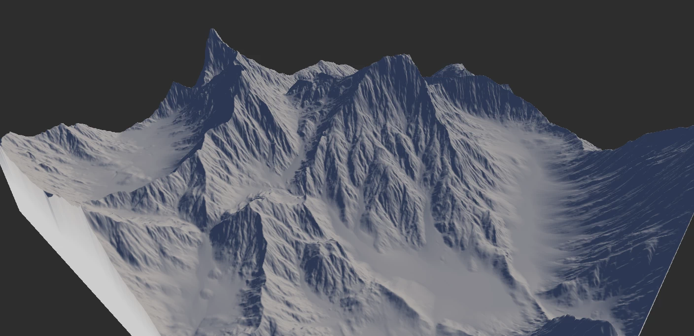

Low Strength with very high Rock Softness retains the general shape. Fewer cracks or fluvial grooves are created, while some soft sediment is accumulated on slopes.
High Strength with very low Rock Softness creates a heavily eroded terrain with plenty of soft sediment.

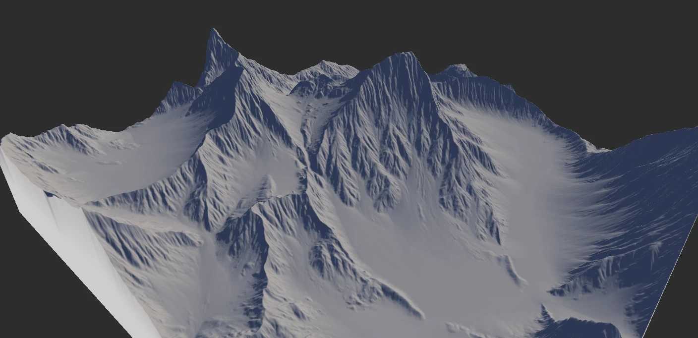

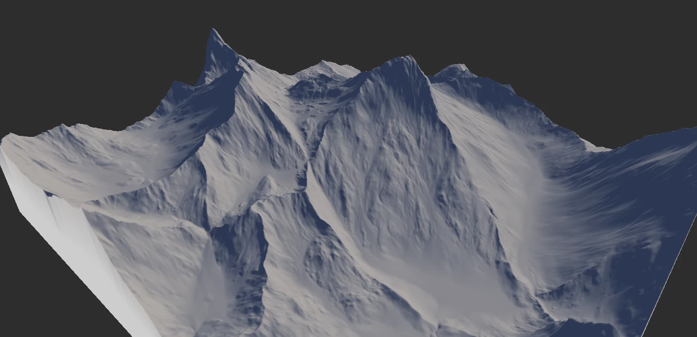

High downcutting with medium Inhibition creates lots of deep fluvial grooves, as well as excess sediments that flow downslope.
High downcutting with very little or no Inhibition will create the same deep fluvial grooves, but no excess sediments.
