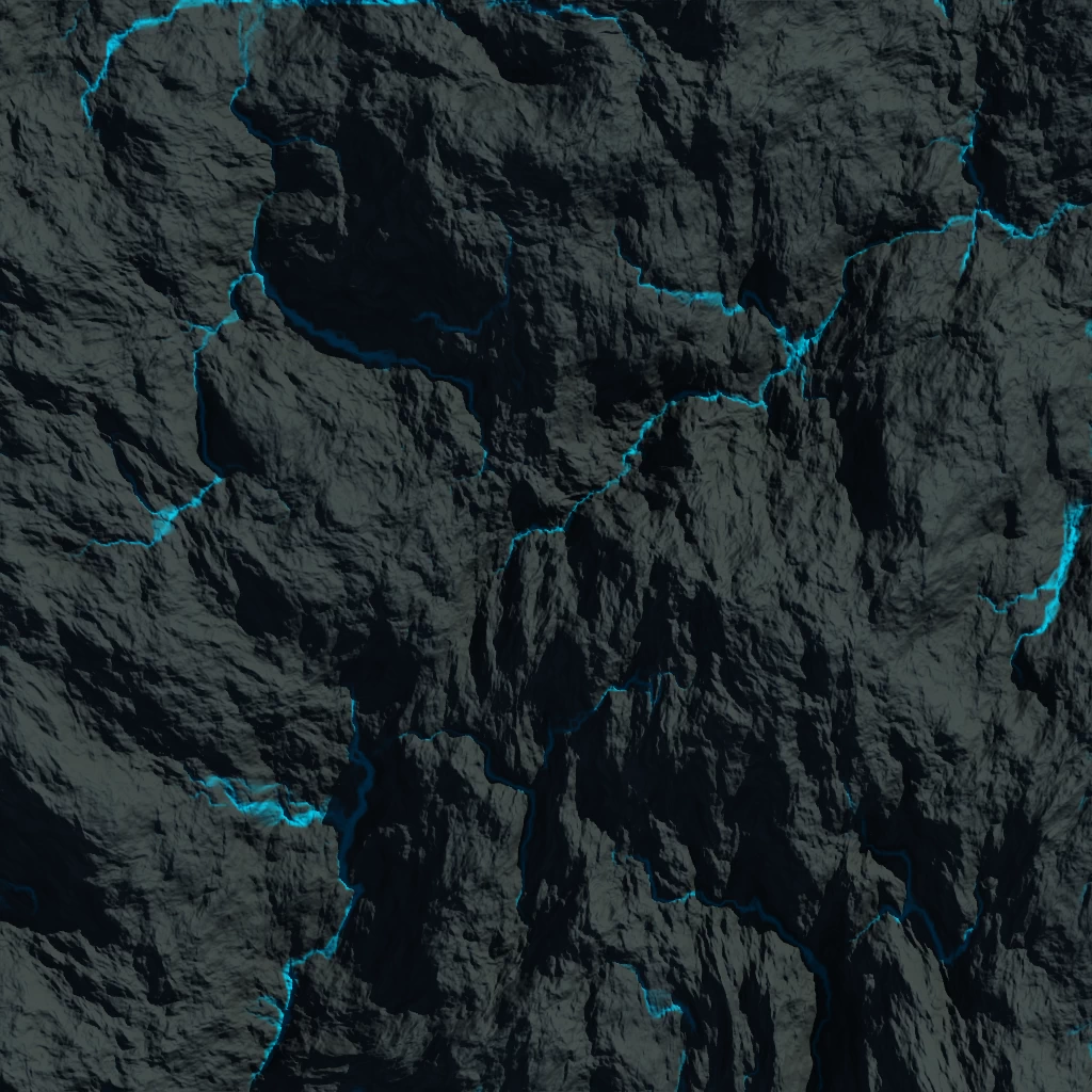

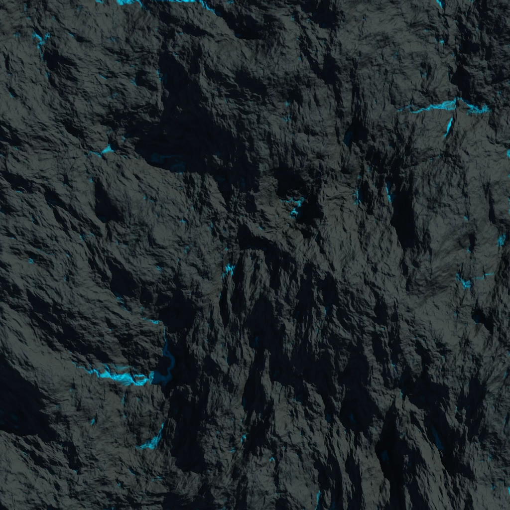

In this example, you can see a simple Perlin with a Flow map. The first image shows the default Perlin, while the second shows the Perlin noise with HydroFix applied. You can see the flow map produces longer and more coherent structures.
