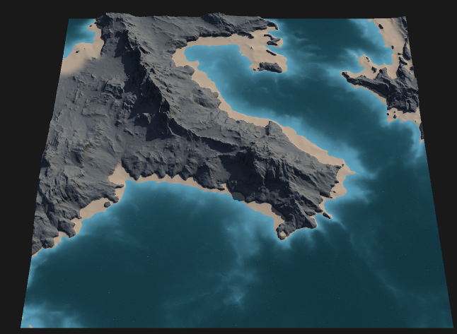

Sea is a multi-function water surface generator and coastal erosion tool. Its primary purpose is to create a water surface, while Coastal Erosion creates beaches and cliffs.
Water, Shore
The water surface can be generated either as global surface or filled from the edges without affecting inland features. In the latter mode, you can have custom control over which edges fill inward by using the Edge input mask.
Use Sea when you want one node to both establish a water surface and shape nearby coastal response.
