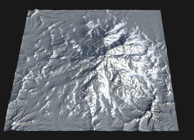

Use Snow when you need simulates snow fall, melt, and settling like in nature, and controls how the snow adheres and flows along the terrain.
