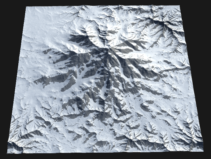

Creates broad settled snow coverage across the terrain surface.

Use Snowfield when you need broad settled snow coverage across the terrain surface.
