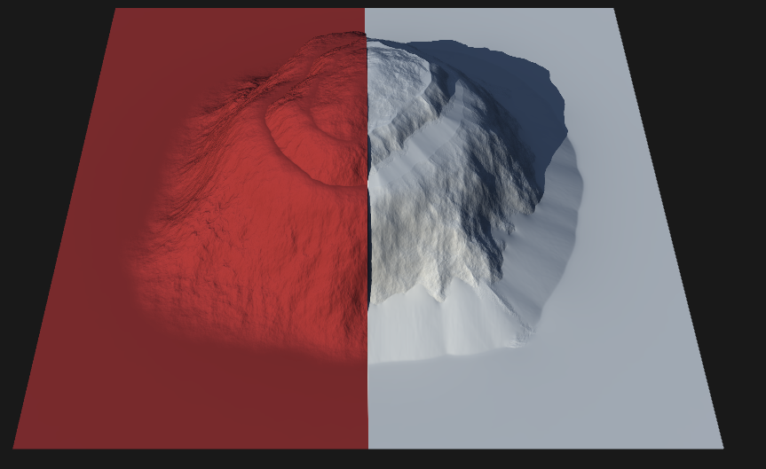

Thermal2 is an evolution of the previous node. It creates Thermal Erosion to create realistic talus and debris.
Official Video
For a video breakdown of this node, see the official Thermal2 video.
Use Thermal2 when you want talus, debris, and slope breakdown that feel driven by thermal weathering rather than hydraulic flow.
