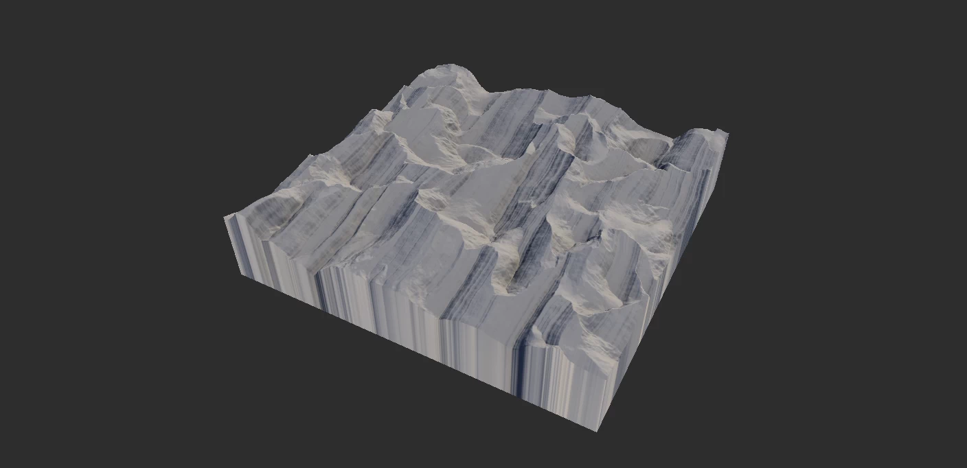

Plates primitive is based on a Perlin core with flat plate-like formations created in between larger Perlin-esque shapes.
Plates is a new primitive, based on a Perlin core with flat plate-like formations created in between larger Perlin-esque shapes. The flat, slanting areas can make great slopes, especially when combined with Displace nodes.
Use Plates when you want a landform base with broad shapes separated by flatter plate-like regions that can be eroded into mesas, basins, or fractured uplands.
