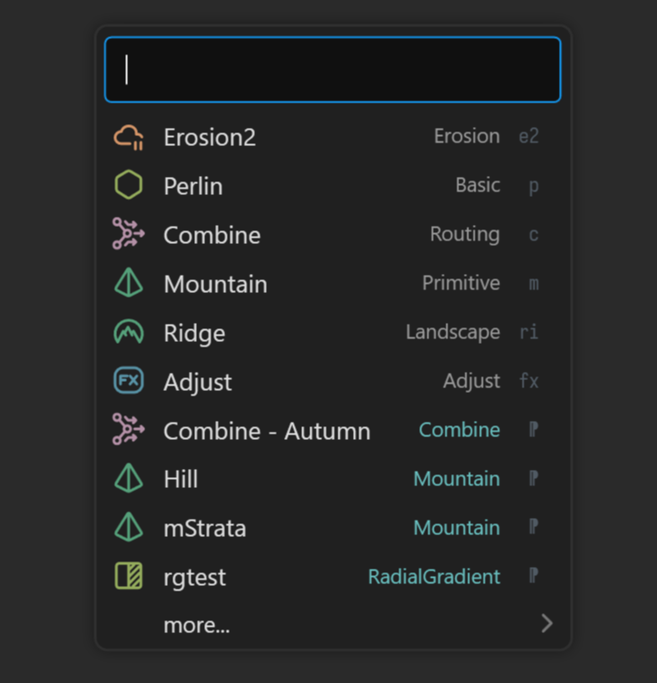

Shortcodes
Each node has a corresponding shortcode. For example, Perlin is p, Mountain is m, Erosion2 is e2, Cone is con, and so on.
You can enter the shortcode instead of the full name when searching for nodes.

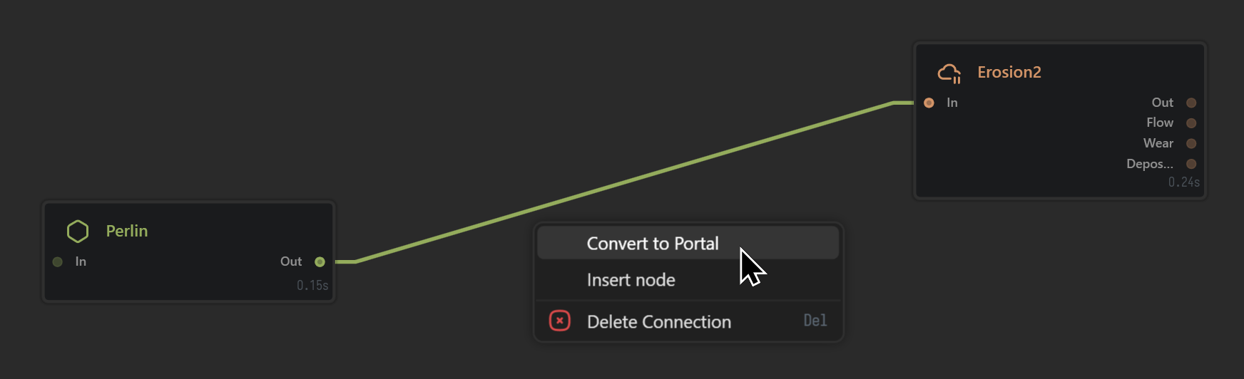

Convert Connection to Portal
Right-click on a connection and select "Convert to Portal" (or press Ctrl + P to convert an existing connection to a Portal. This will also convert the Out port to a Portal.
Other connections associated with that Port will not be affected.

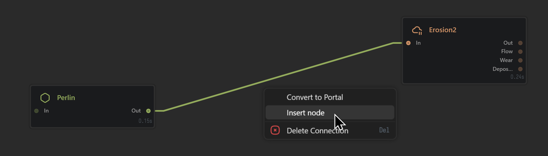

Insert Node
  • Right-click on a connection and choose "Insert node". This action opens a search menu.
  • Select the node you wish to insert from this menu, and it will be automatically placed between the existing connection.

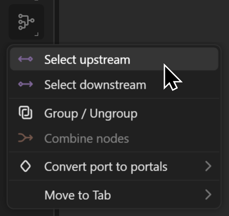

Select Nodes
You can select all nodes upstream (ancestors) or downstream (descendants) of a specific node from the Node menu or the Graph Toolbar.
Group/Ungroup nodes
To create a group, select multiple nodes and choose "Group/Ungroup" from the menu. This action groups the selected nodes together. Clicking "Group/Ungroup" again while a group is selected will ungroup the nodes, placing them individually back onto the graph.
Combine nodes
Select two or more nodes and click on the "Combine Nodes" menu option. This will connect the selected nodes using a combine node.
Convert port to portals
This feature displays a list of output ports. Click on a port to convert it into a portal.
Move to Tab
This option provides a list of graph tabs. Click on a tab to move the selected nodes to the selected tab.
