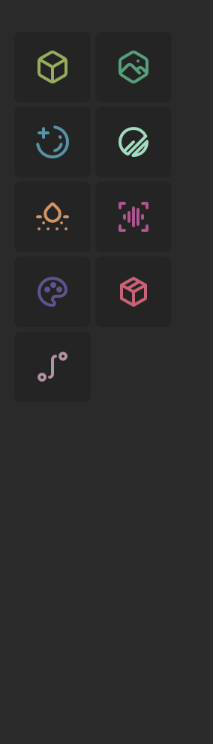

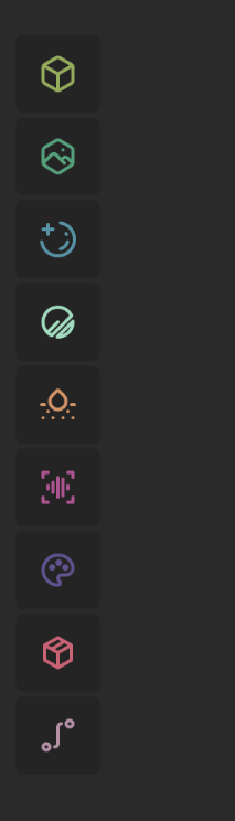

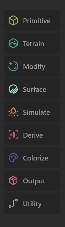

You can drag the right edge of the Toolbox to switch between three layout styles depending on your preferences for verbosity or compactness.
Expanded Compact Toolbar

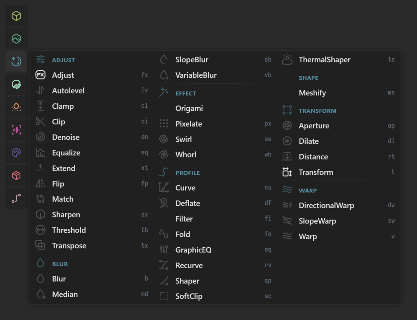

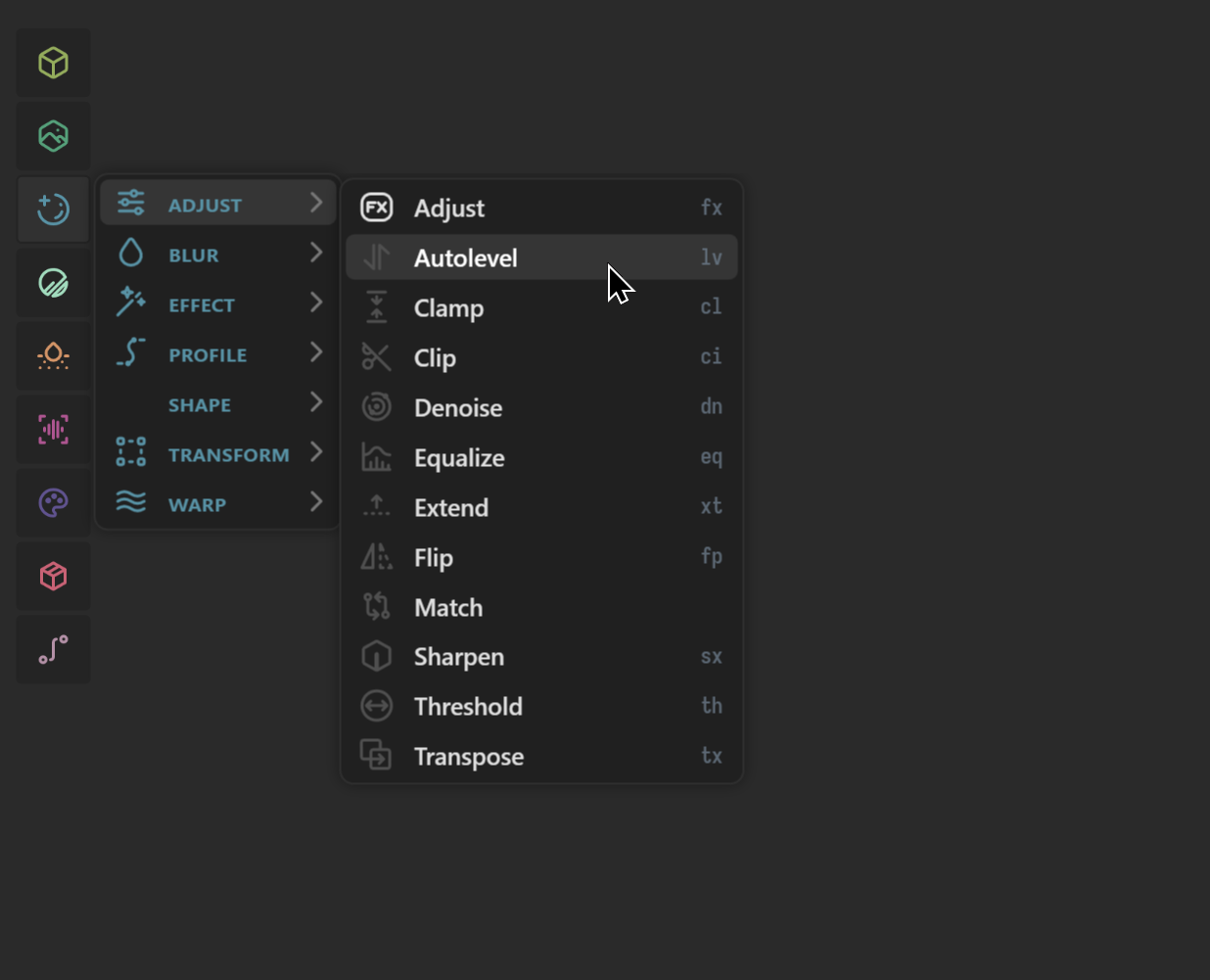

Nodes inside the Toolbox are organized by Family. You can choose how to visualize this organization.
Nested (Default): Toolbox menus are nested by Family then family members to avoid clutter Flat: All Families and family members are shown in a flat menu
