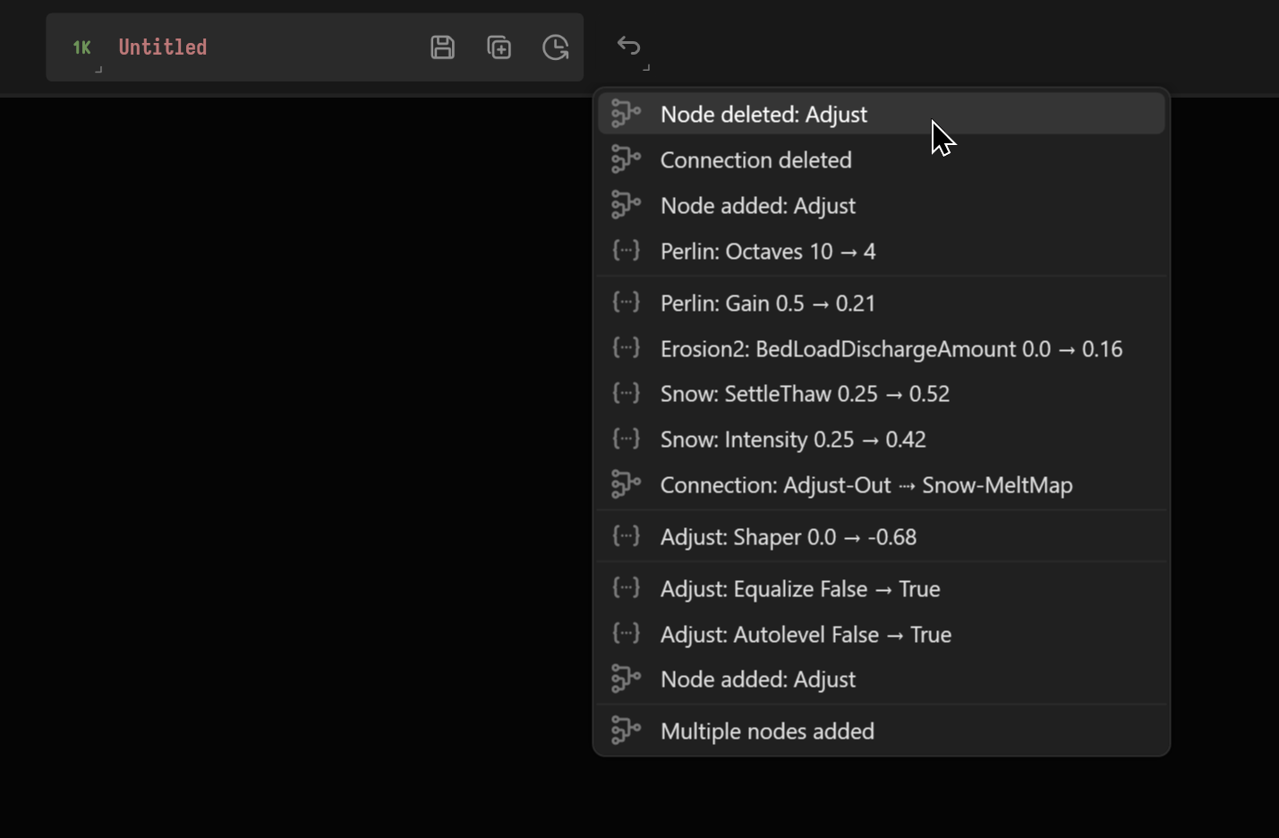

Undo Menu
The Undo menu lists recent actions and allows you undo them.
The Undo menu also acts as a history readout, showing you exactly what changes were made in each step. For example, when a node value is changed, it will show you the name of the node, the name of the modified property, and the before and after values.
