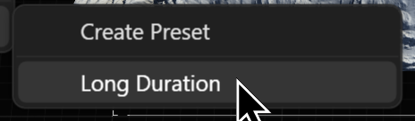

Clicking on "Create Preset" button will create the preset. We have named the preset "Long Duration". This new preset will now be visible in preset menu. clicking on this preset will apply its settings to the selected node.
You can create multiple presets with various node settings.
