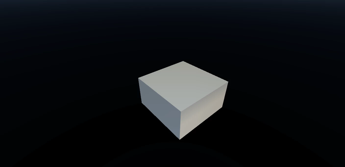

Scale Philosophy
Gaea uses a vertical ratio to maintain scale. This is because we describe the world in meters (e.g., 5000m x 5000m x 2500m) to retain a consistent scale, but we use pixels in specific sizes (e.g., 4096px x 4096px) to store our data (as needed by CG applications) which is a finite and arbitrary unit which can't map to pixels. In addition, each pixel's value is stored as a high-precision decimal value (0.005893f) which is also an arbitrary, but ratio-based, unit.
Therefore, we use a simple formula to create and retain the height of the terrain:
$$ \text = \frac{\text}{\text} = \frac{2500}{5000} = 0.5 $$
The default Gaea world is 5000m wide and 2500m tall, creating a perfect 0.5 ratio.
