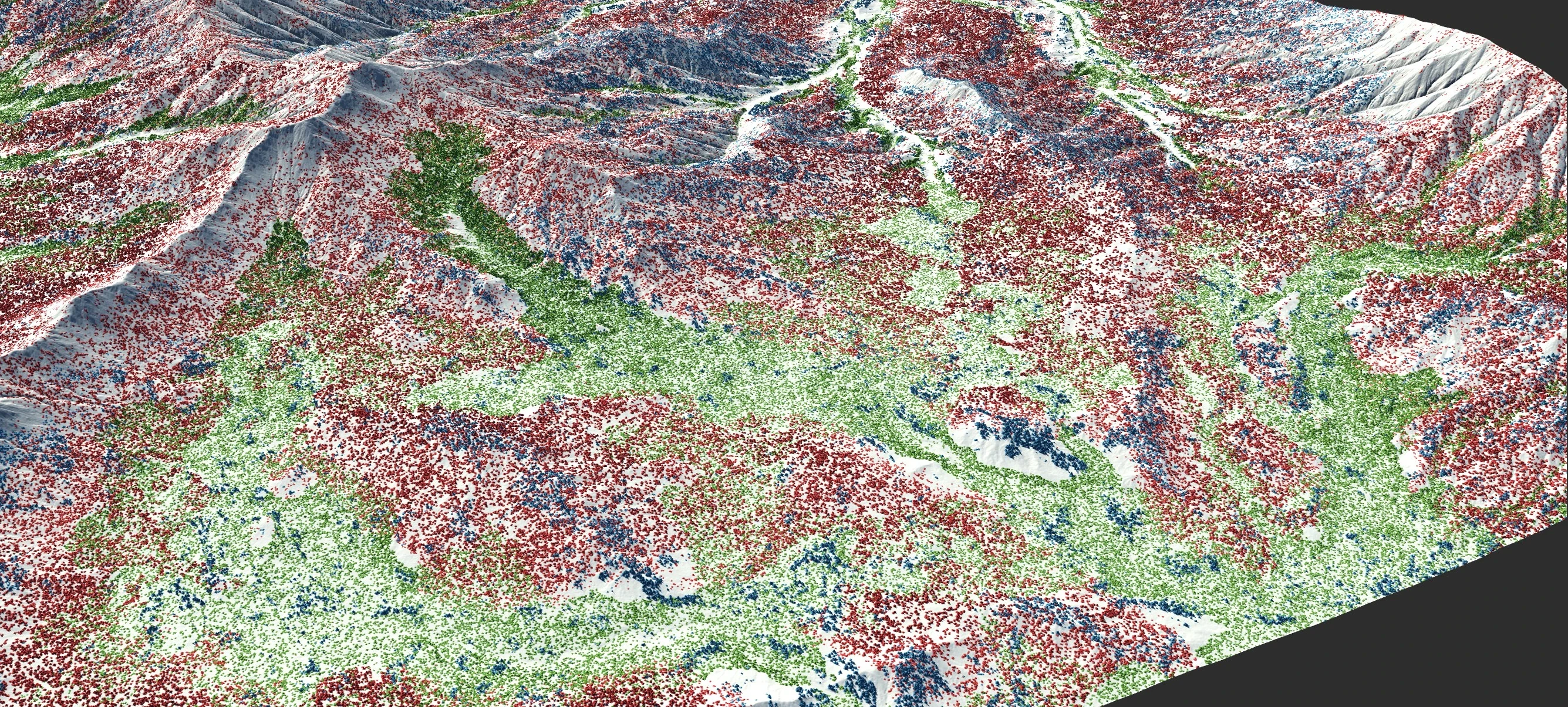

The Terrain
![](/.data/using/getting-started/basics/exporting-elements/r2.webp) ![](/.data/using/getting-started/basics/exporting-elements/sophia-2-acdsee-photo-studio-home-2024.webp)
This can either be a 32-bit displacement map or a high precision mesh. It is the most essential part of your project. Game engines would use 16-bit displacement maps.

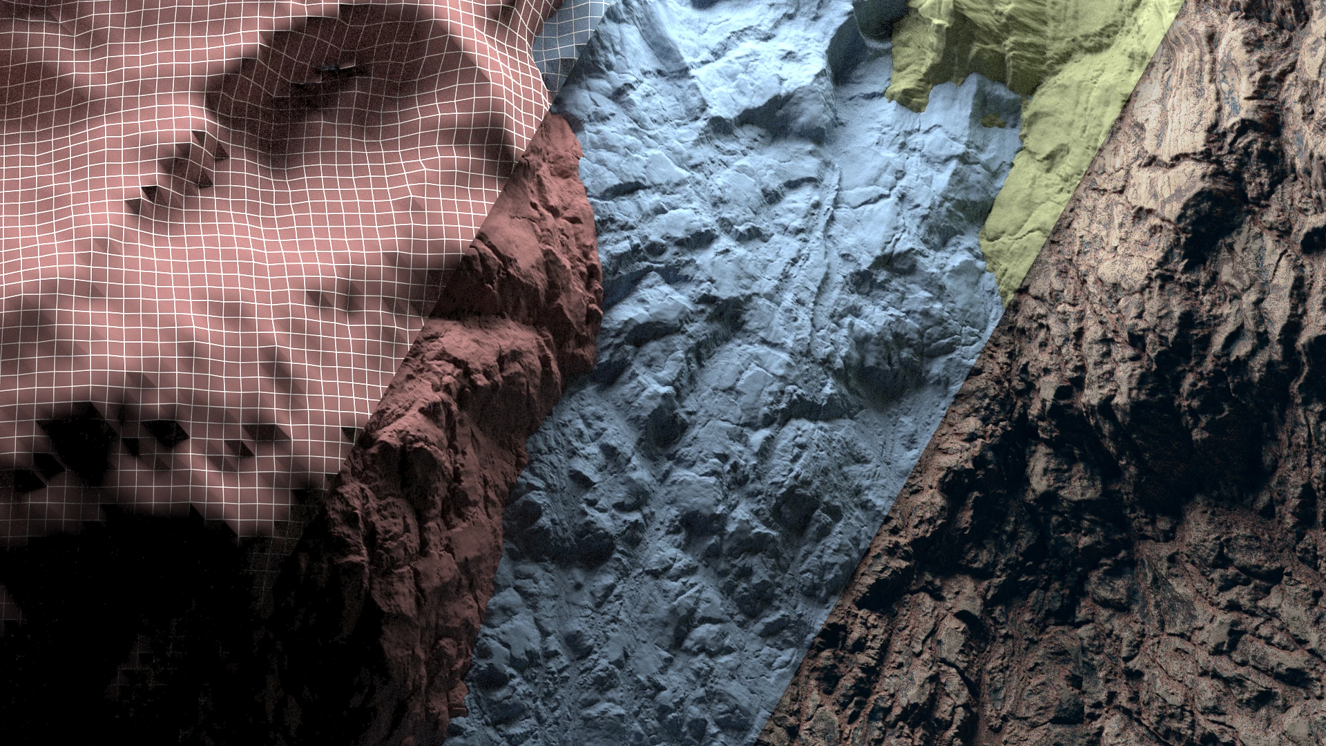

Color Map
![](/.data/using/getting-started/basics/exporting-elements/r4.webp)
If you have constructed a color map that will be the Diffuse/Albedo map for your terrain, then this will be exported as either an 8-bit or 16-bit bitmap.

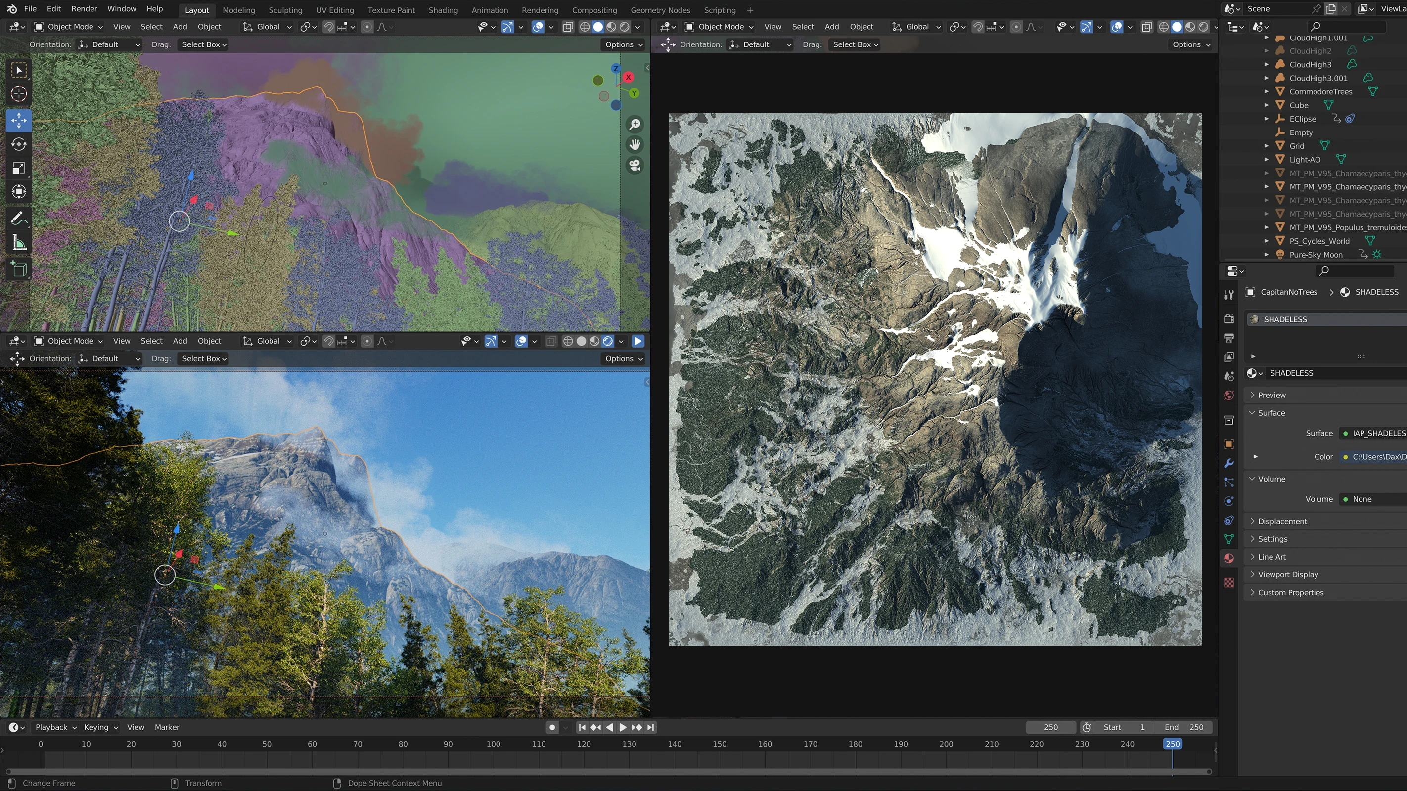

Rendered / Baked Lighting
![](/.data/using/getting-started/basics/exporting-elements/r1.webp)
The Light node lets you use high-precision rendering to create a fully realized render that you can use for direct application on your object.
In this example below, the mountain uses a baked lightmap on an unlit shader in Blender to dramatically reduce rendering time.
