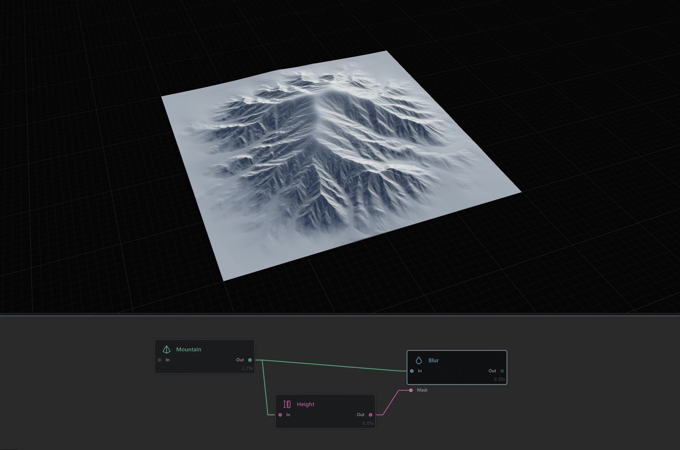

Direct Masking
.webp)
- To apply a mask, connect the mask output from one node into the mask input of another node. This setup allows the second node’s effects to be limited to the areas defined by the mask.
- For example, if you want to apply erosion only to the upper regions of a mountain, use a height-based mask that isolates those areas.

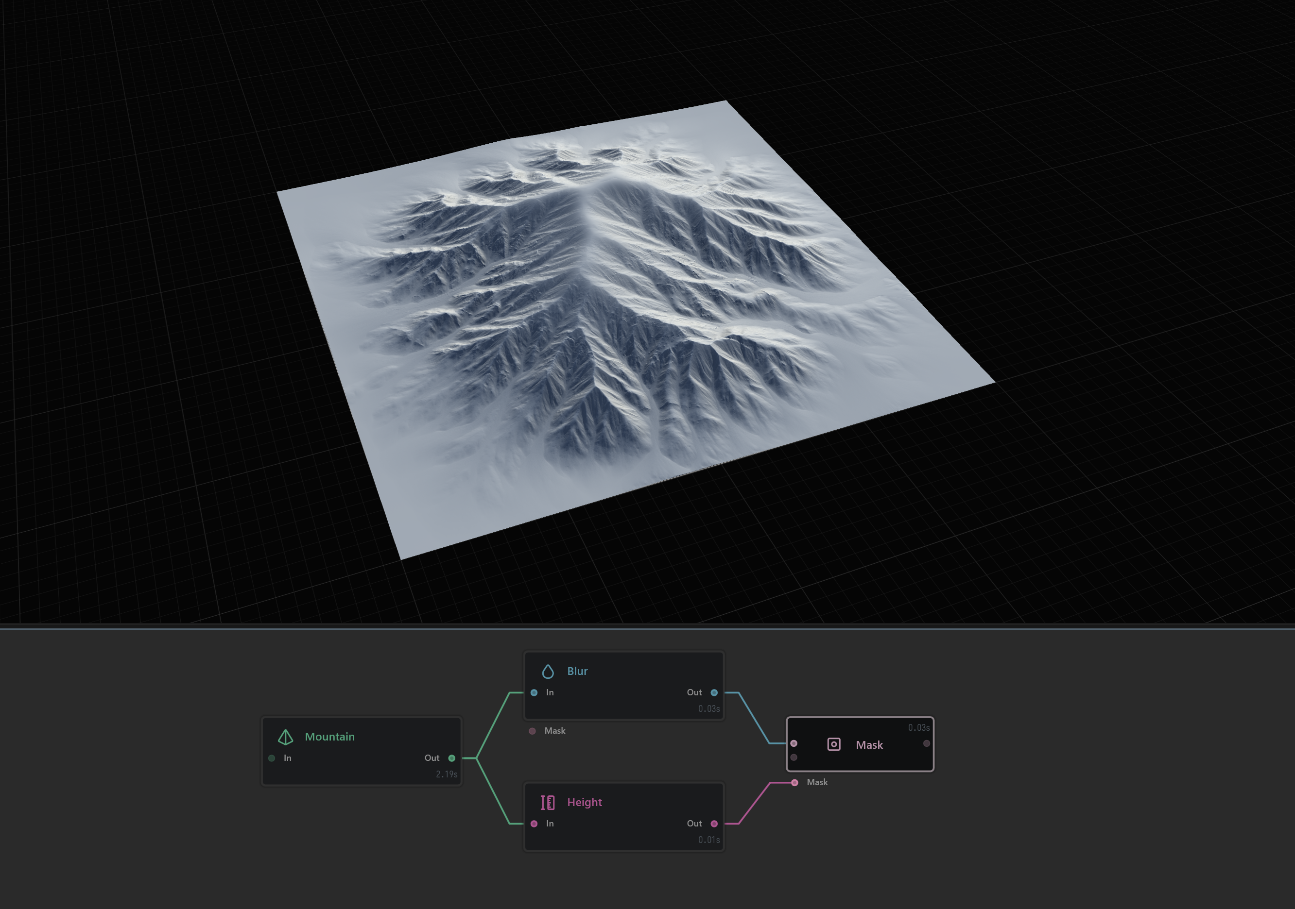

Post-Masking
.png)
- Gaea 2 introduces the new
Masknode which allows you to mask the node/effect after it has been created. You can connect the Mask node after an effect has been applied. For example, in aMountain > Erosion > Maskscenario, the Mask will automatically use the applied mask between Mountain and Erosion. - If you have multiple nodes that create the "effect" you wish to mask, just connect the second port of the Mask node to the desired "before" node. For example, in
Mountain > Erosion > Sandstone > Thermal2 > Mask, you would connect the second input to Mountain. - This is very useful because when a node is masked directly, a change to the mask will force a rebuild of the entire node. A Mask node, however, adds masking as a post-process and is extremely fast.
There is no difference in results between the Mask port on a node and the Mask node. It is highly recommended that Mask node be used when possible as it will make your builds faster, and adapt your workflow to the modern specifications recommended by Gaea 2.0.
