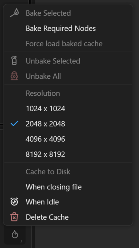

Baking Menu
Baking Features
Bake Selected. Use this option to bake the selected node(s) in the graph. Baking a node saves its current state at a chosen resolution, which allows for faster loading and prevents the node from being recalculated unless explicitly unbaked or modified.
Bake Required Nodes. This option is used to bake nodes involved in tiling operations, ensuring seamless tiling across different segments of a terrain without needing to reprocess the entire terrain each time adjustments are made.
Force Load Baked Cache. Forces the application to reload the baked cache, useful for when changes in the system or project environment may prevent the automatic loading of cached data.
Unbake Selected. Reverses the baking process for selected nodes, making them editable again. This is necessary when adjustments are required on previously baked nodes.
Unbake All. Removes the baked status from all nodes in the project, allowing for full graph reprocessing and editing.
Resolution Settings. Choose the resolution at which the nodes will be baked. Available options are: 1024 x 1024, 2048 x 2048 (default), 4096 x 4096, 8192 x 8192
Selecting a higher resolution for baking is beneficial when working on detailed sections of the terrain, as it provides clearer and more accurate previews.
