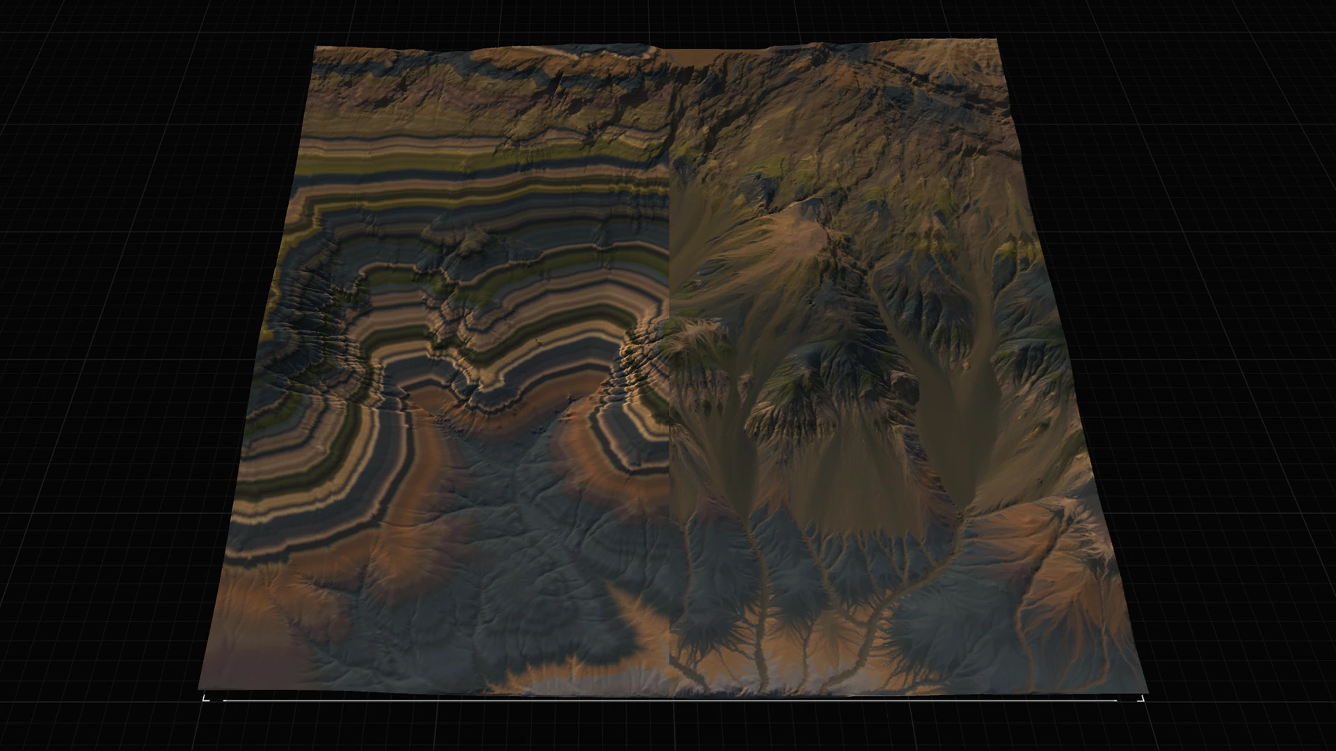

Using Directly
You can apply a SatMap directly a terrain, with or without a TextureBase or Texturizer node in between, and simply apply ColorErosion to get decent layered sedimentary flows.

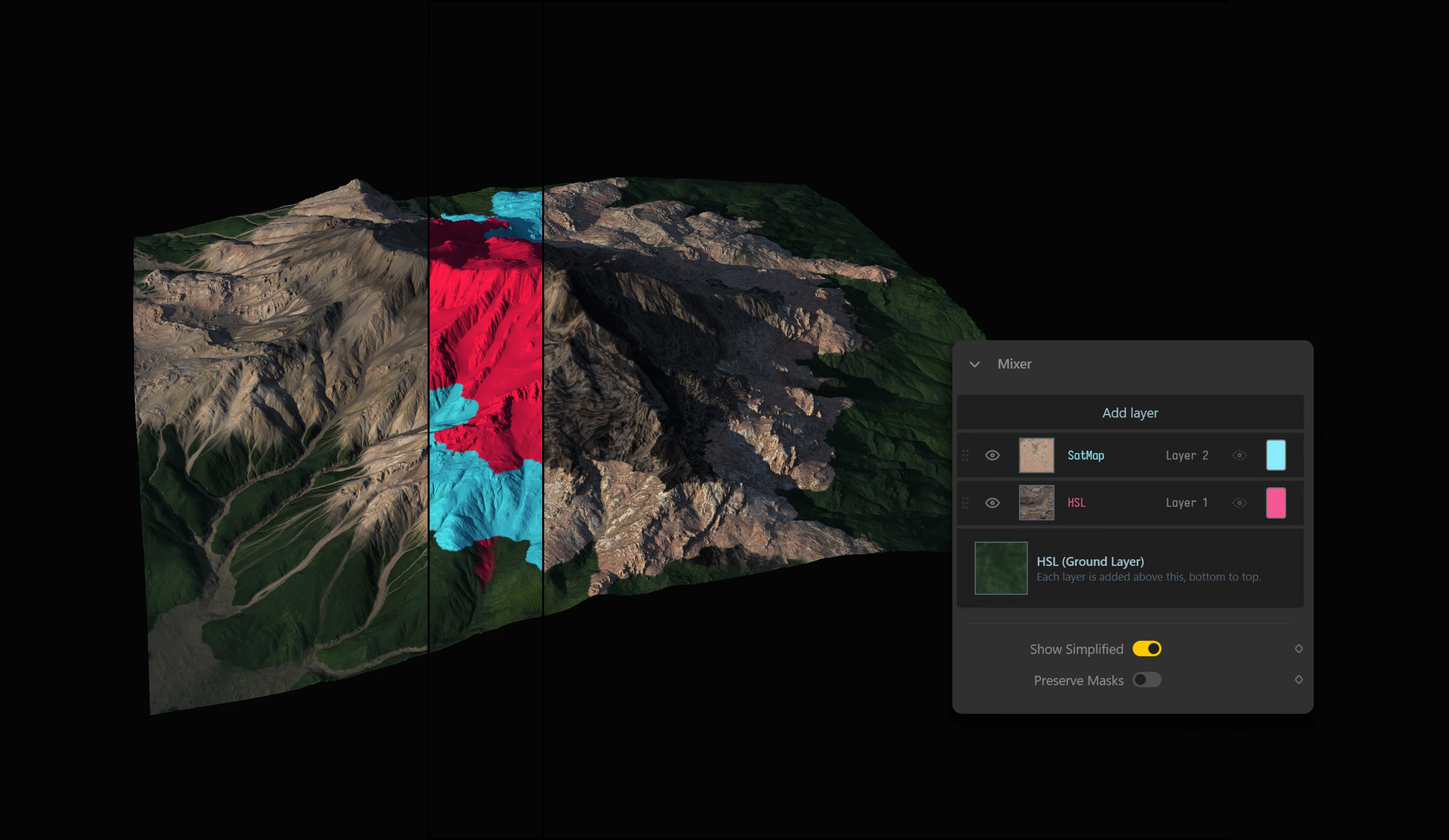

Using with Mixer
The Mixer node is very helpful in preparing the color map before applying ColorErosion as you can change different color strata before eroding, and choose exactly how and where they may flow.

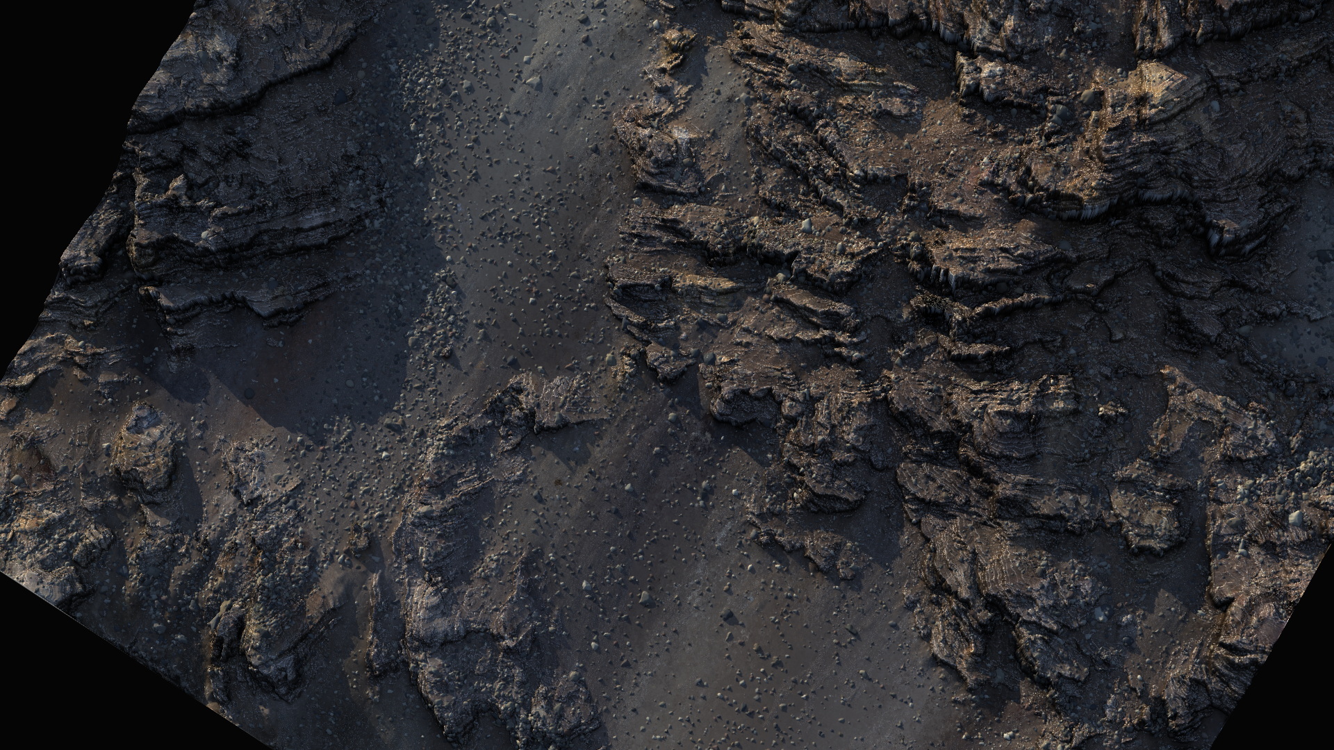

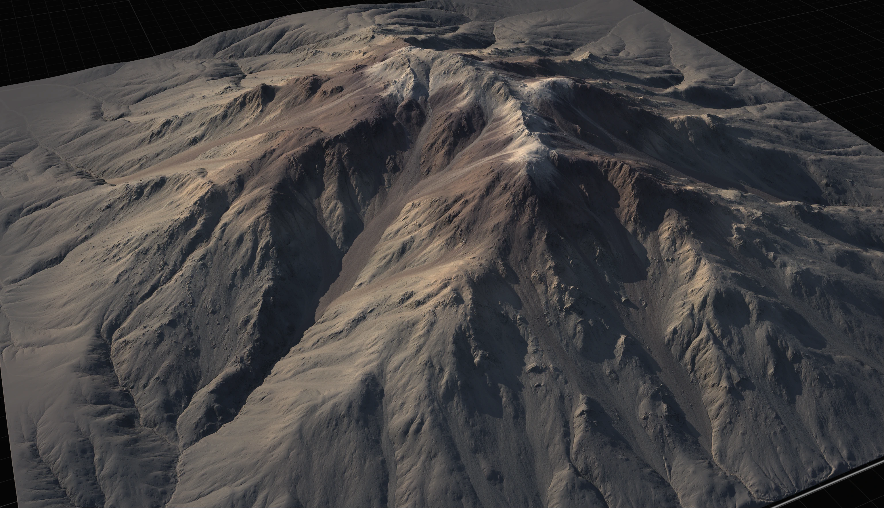

Sophisticated Use
You can also create more subtle, sophisticated texturing with ColorErosion as shown in the Complex Scene - Debris example that is included with Gaea.

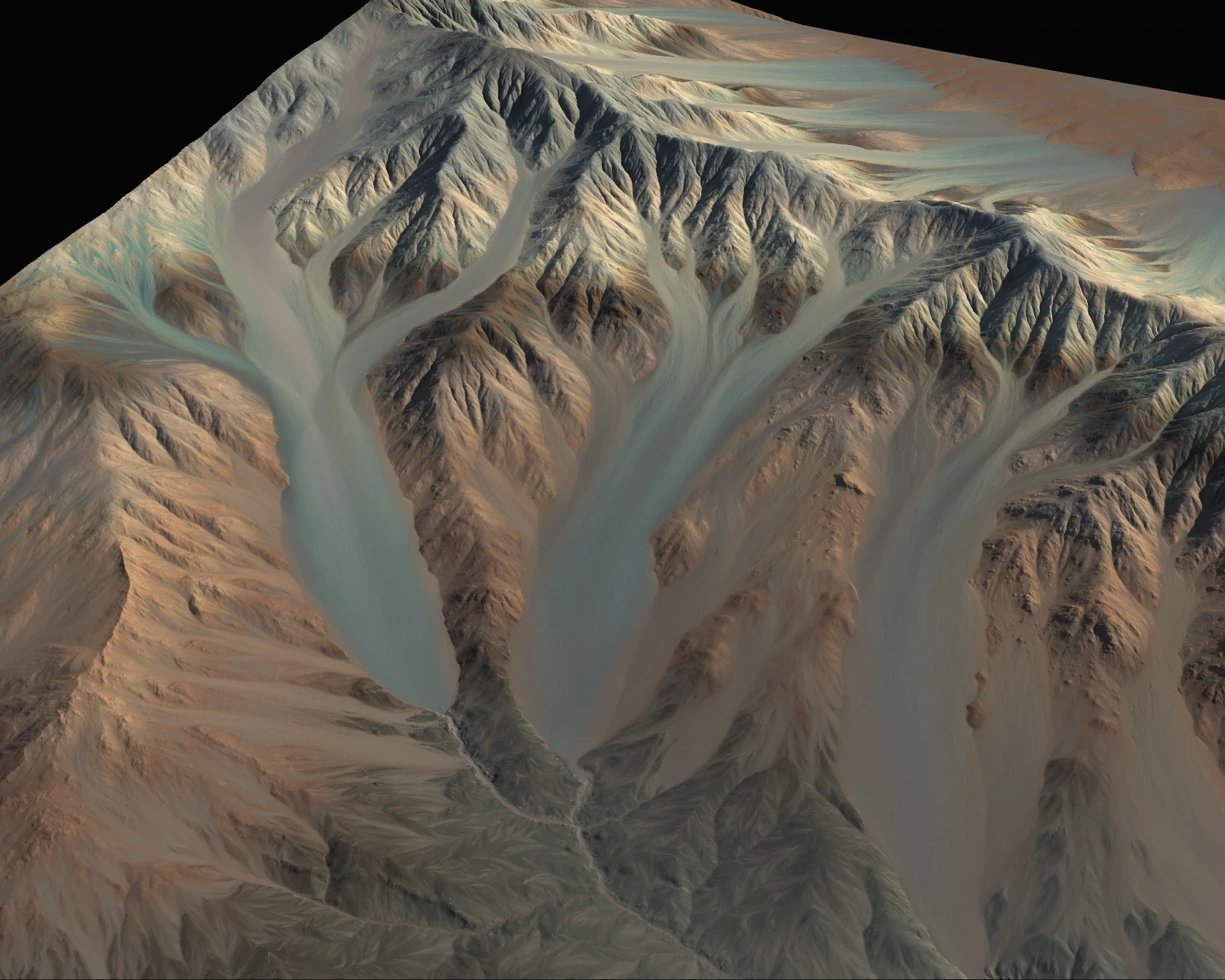

Understanding How Color Moves
ColorErosion can be a very creative component whether you are creating something realistic or stylistic. The core understanding required is how color placed high up flows with existing sediment flows.
Experiment with various color layers, whether you use SatMap's Bias slider or various layers with Mixer, and see how the erosion reacts.
