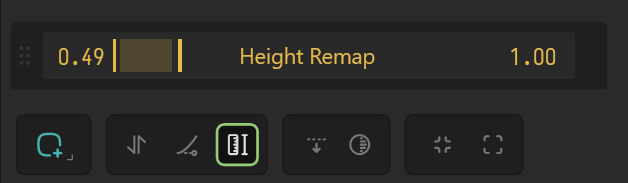

Adjusting the Height
If a terrain (or mask) is not the exact height values you need, you can use the Height Remap modifier to adjust both the lower and upper extent of your terrain. Bringing up the bottom "raises" the terrain from the bottom, while "lowering" the top makes the terrain shorter.
Inversely, bringing the top beyond 1.0 makes your terrain taller than the original range.

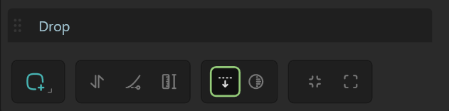

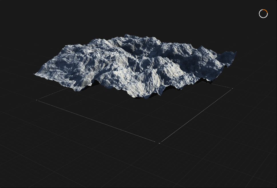

Dropping the Terrain
The "Drop" modifier removes any "empty" space under the terrain, forcing it to drop to the "floor".

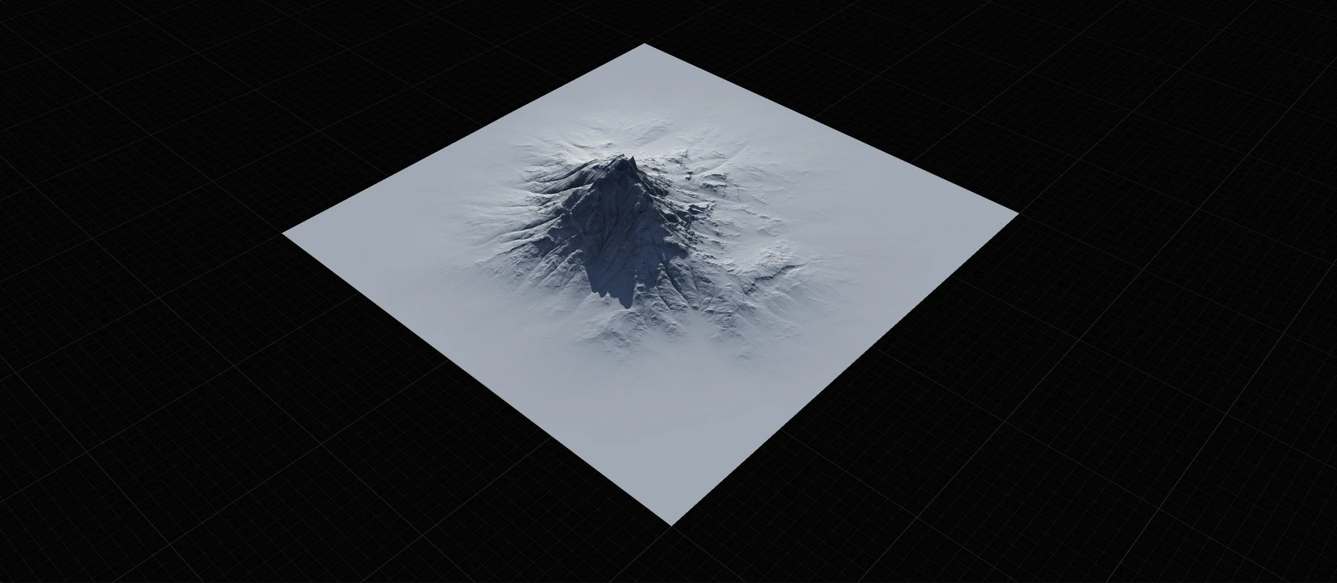

Normal Perlin
Normal Perlin
Dropped Perlin
Dropped Perlin

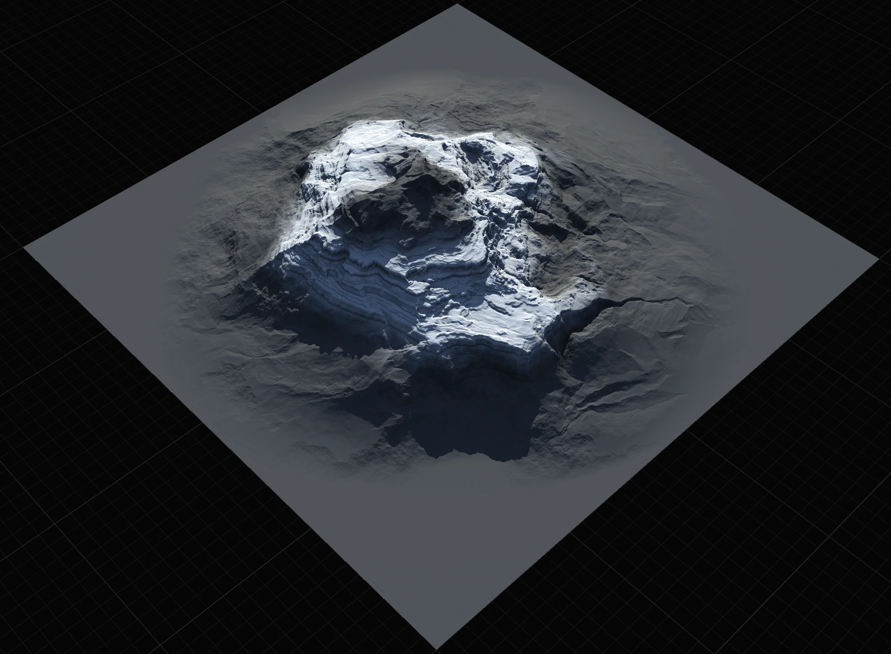

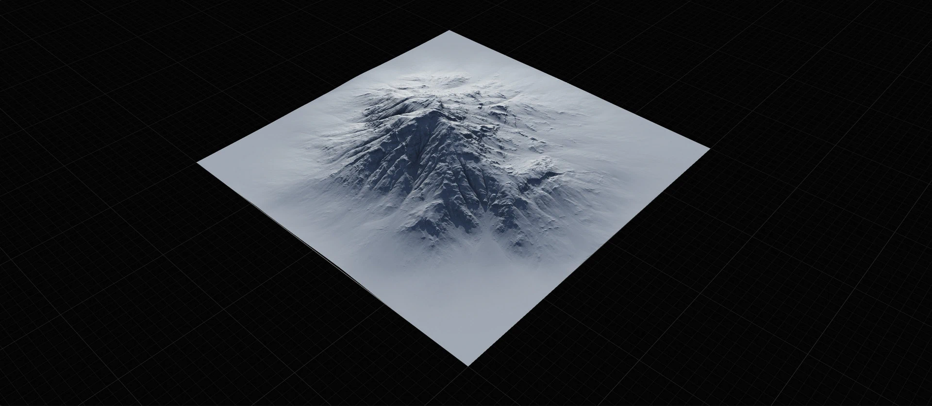

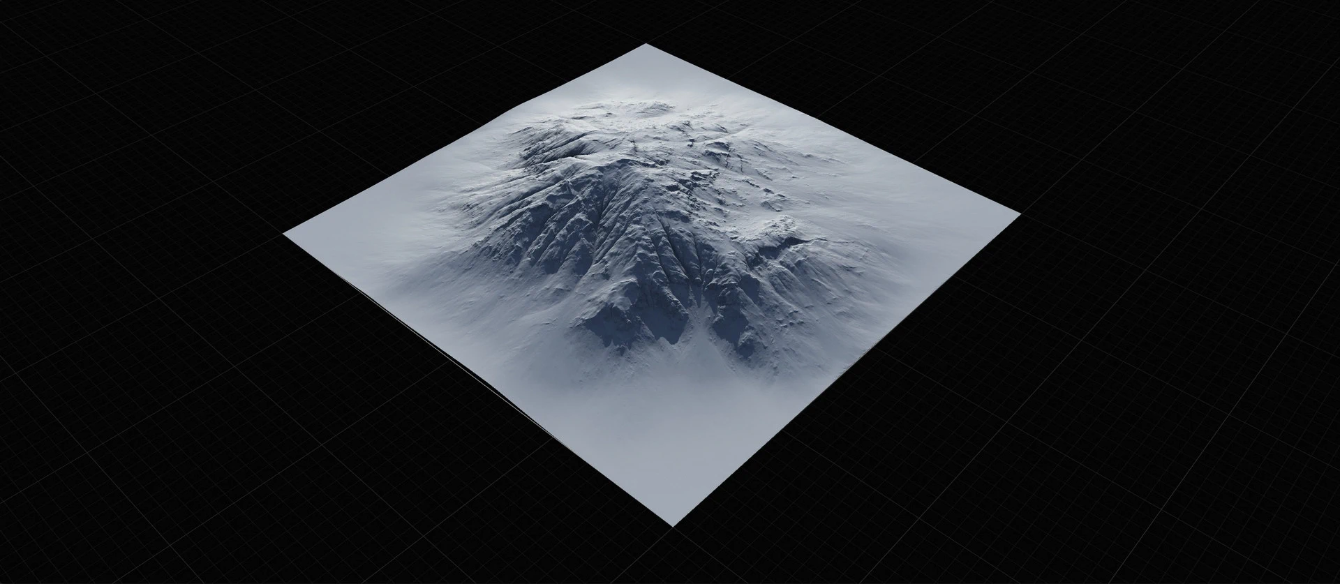

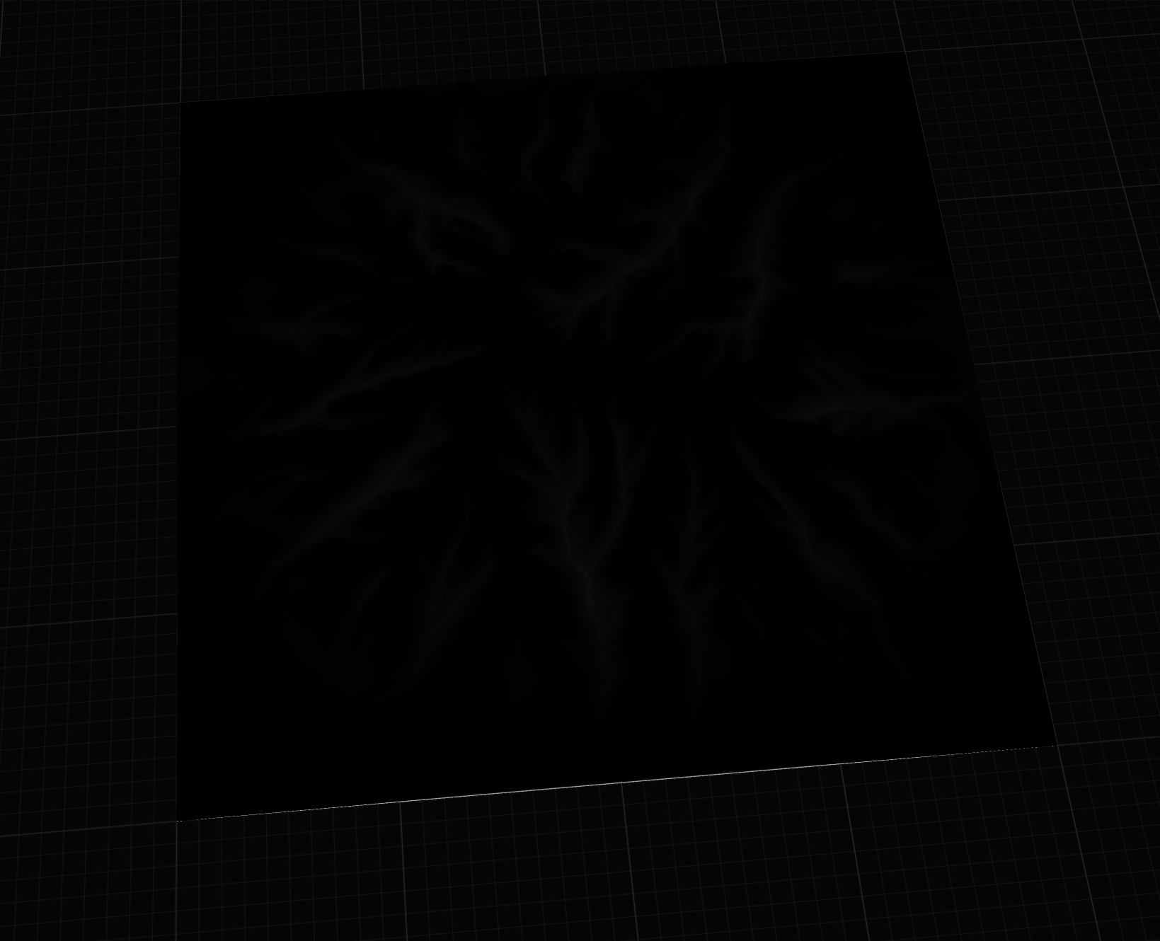

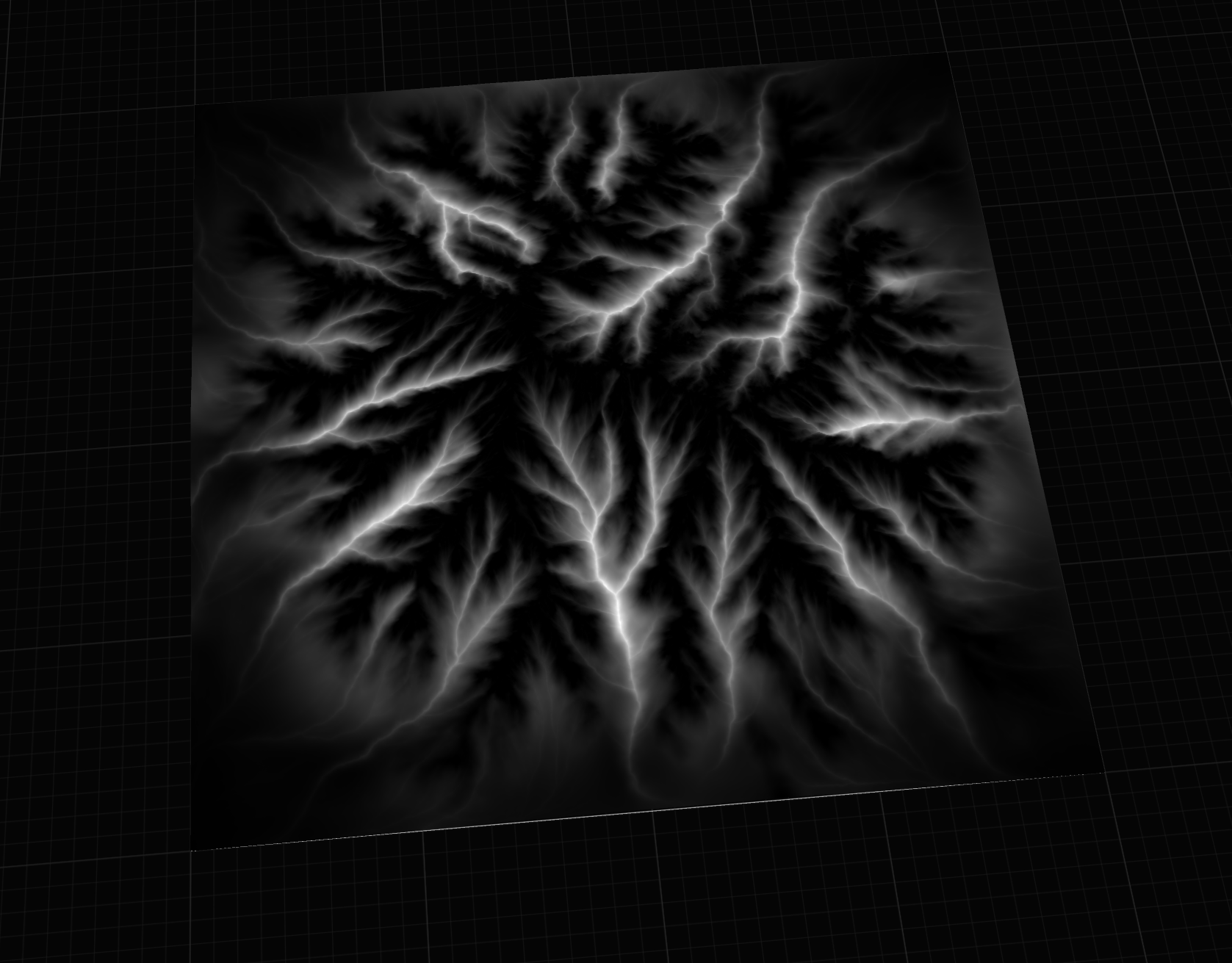

Using Shaper, you can bulk up or bulk down a terrain. It can apply to masks as well. For example, taking Flow Map output and making it stronger by adding Shaper.
Original terrain
Shaper at +50
Shaper at +50
Shaper at -50
Shaper at -50

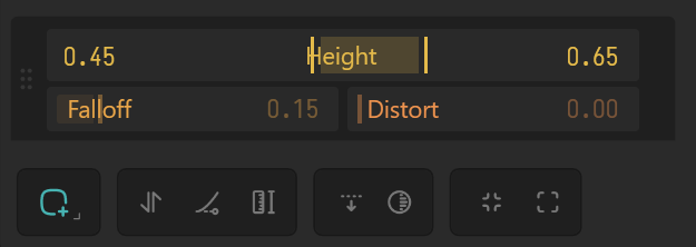

You can easily restrict the effect of a node to a height or slope range by adding a "Mask by Height" or "Mask by Slope" modifier on the effect node.
You can attach a DataExtractor node to any node that uses a Mask by Height/Slope modifier, and get the exact mask generated as a separate output.

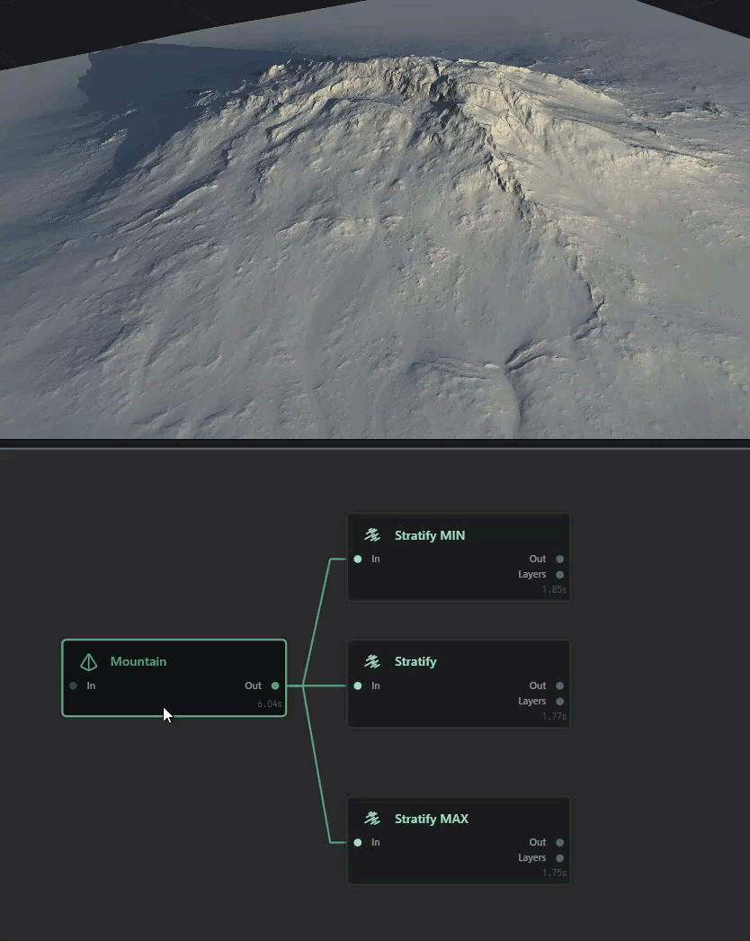

Using Min and Max
The Min and Max modifiers are one of the most powerful tools in Gaea.
Min and Max work like the Min and Max blend modes in Combine, but they compare the node's processed result against the node's original incoming terrain instead of comparing two separate Combine inputs.
Per pixel, Max keeps the areas where the modifier result became higher. Min keeps the areas where the modifier result became lower.

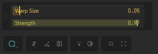

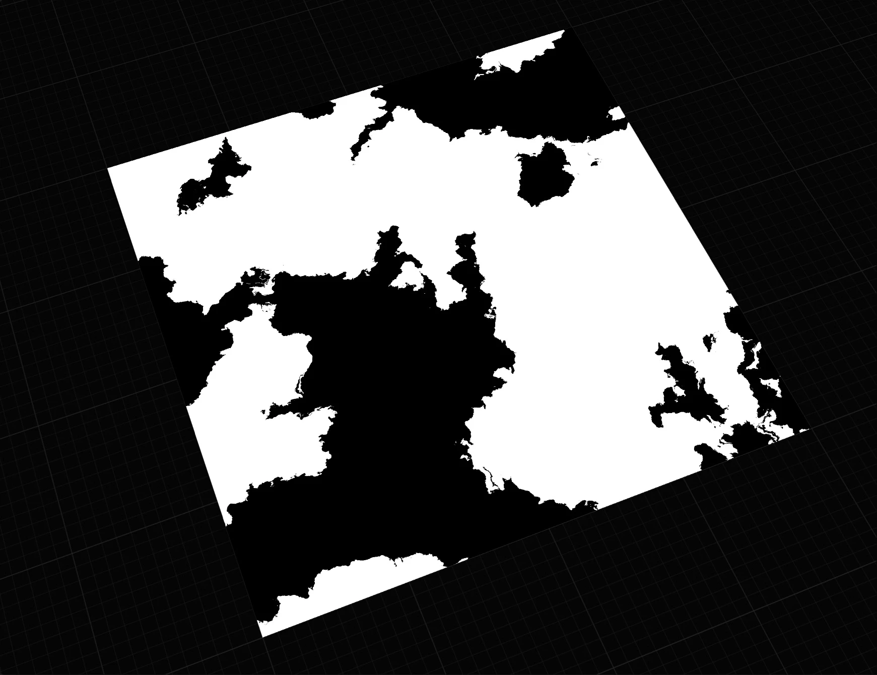

Breaking up a Mask
Sometimes you want a bit of crunchy detail to breakup the edges of your mask or introduce some uneven variations. Add a Warp modifier with the appropriate Size and Strength to change the mask.
Try mixing with Min or Max modifiers for broader options.

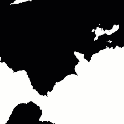

Softening a Mask
When a mask is too hard or creates obvious cut lines, add a small Blur modifier to soften the transition. This is useful before using the mask to control erosion, texturing, color, or any effect where a sharp boundary would look artificial.
Use only as much blur as needed. Too much blur can make the mask lose the specific area it was meant to isolate.
