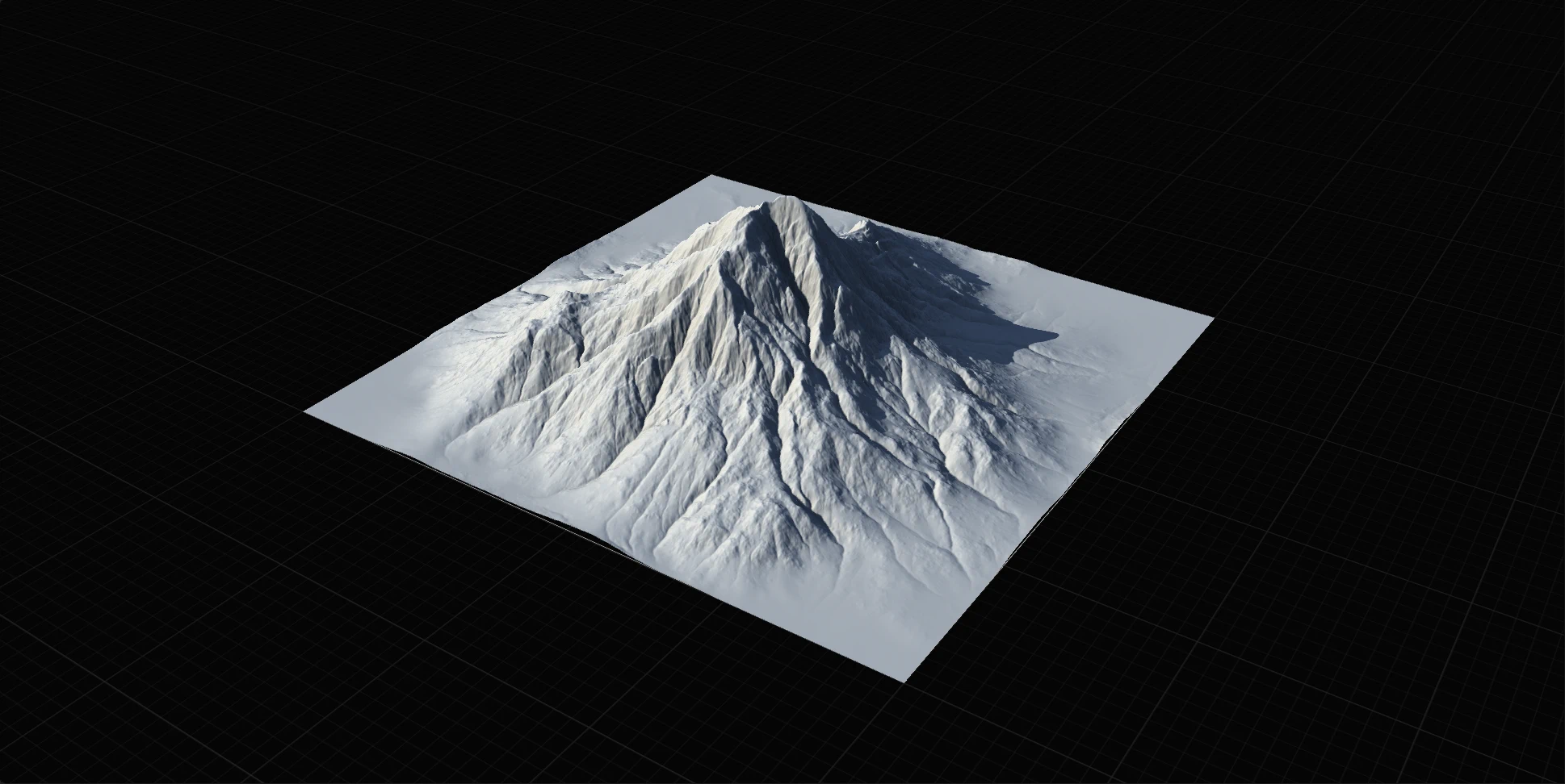

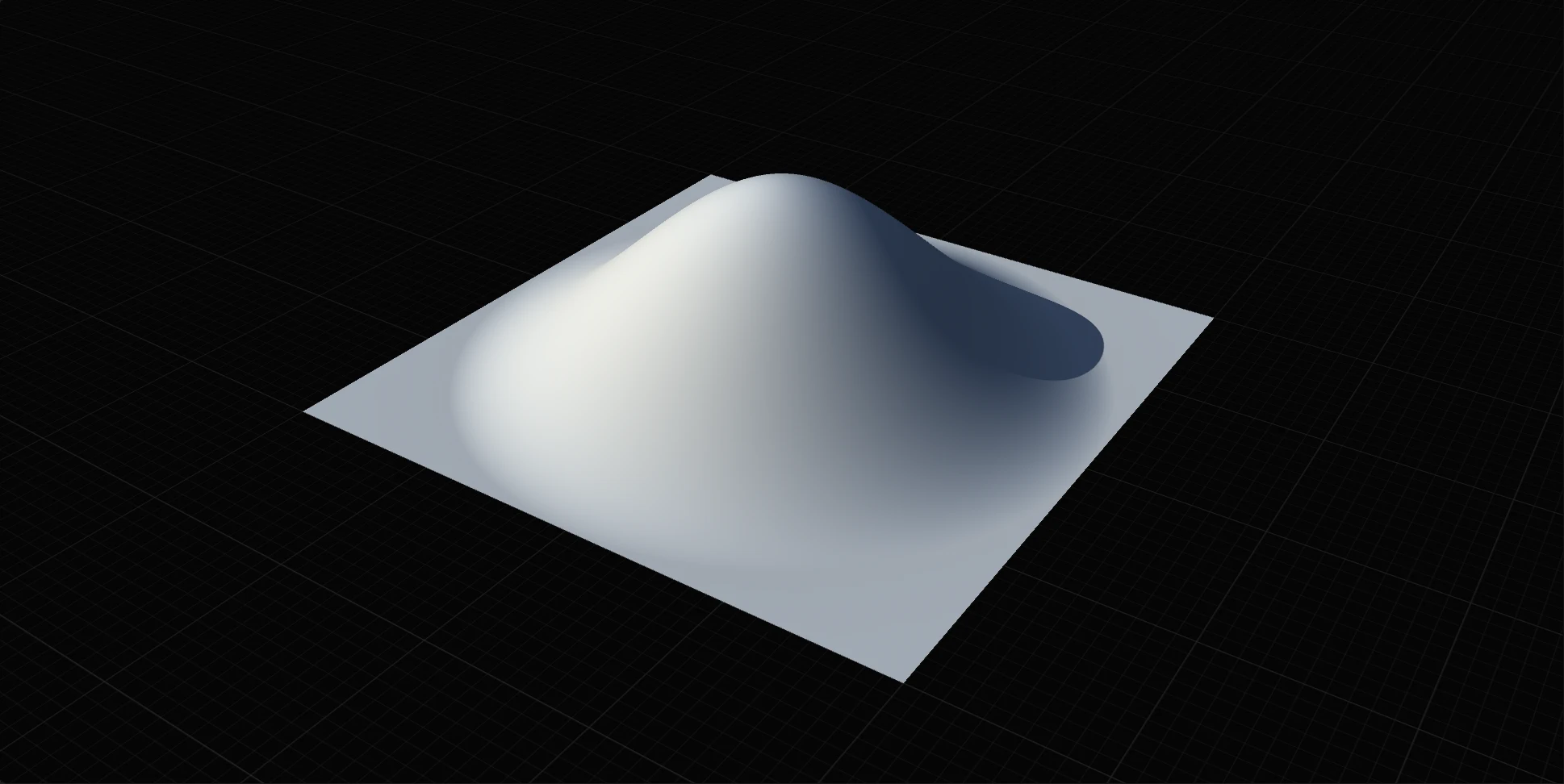

We start with a RadialGradient with absolutely no features. We apply Warp to add noise warping to the smooth shape to bring out some random detail. Then we apply 2 passes of Erosion_2 and let it automatically carve out realistic details into the terrain.
A basic RadialGradient primitive.

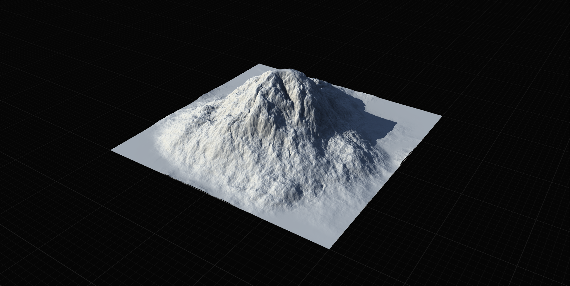

Add Warp (either with a Warp node, or the Warp modifier) to the RadialGradient.
Erosion_2 pass 1 to create the larger gullies and fluvial structures.

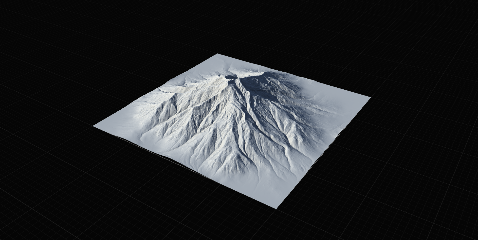

Erosion_2 pass 2 to soften some of the ridges and compact the terrain further.
