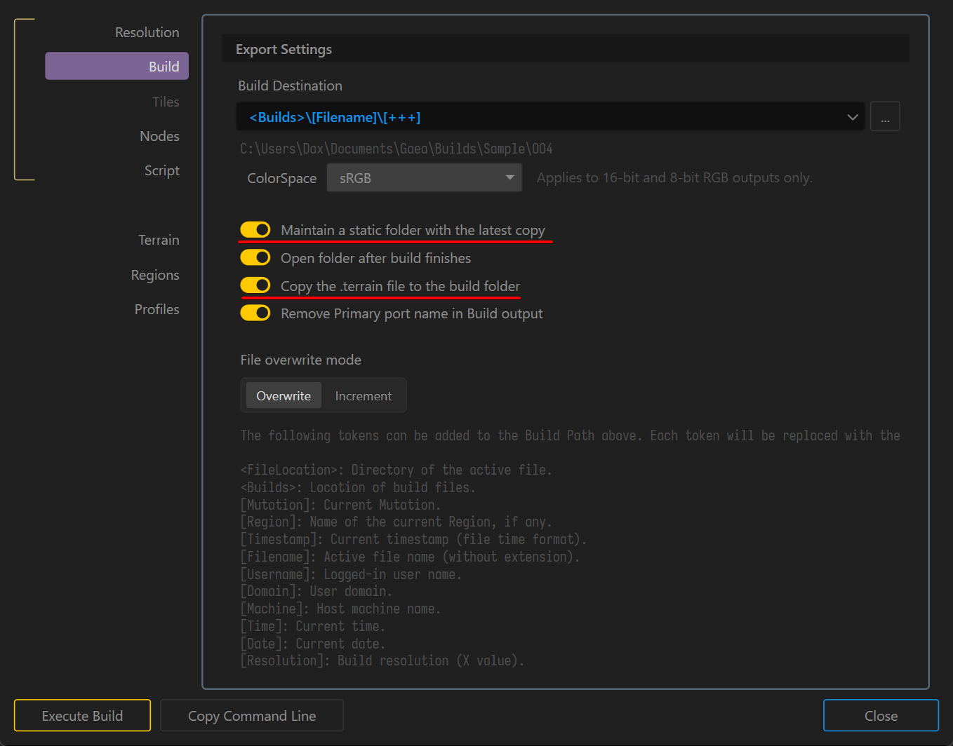

Gaea 2 includes an option in Build Options (Build tab) called Maintain a static folder with the latest copy.
Enable "Maintain a static folder" to maintain a constant folder with the latest build
Enable it while still using an incremental destination pattern like [+++]:
  • Gaea continues to write each build into its own numbered folder (so you keep every build).
  • Gaea also copies the newest build into a sibling folder named Latest.
Point your DCC file links to the Latest folder. Your references stay stable across rebuilds, while you still retain archived outputs per build.
Optional: enable Copy the .terrain file to the build folder to store an exact snapshot of the terrain file used for each build. This is useful for tracking changes across iterations and rolling back to a specific version.
