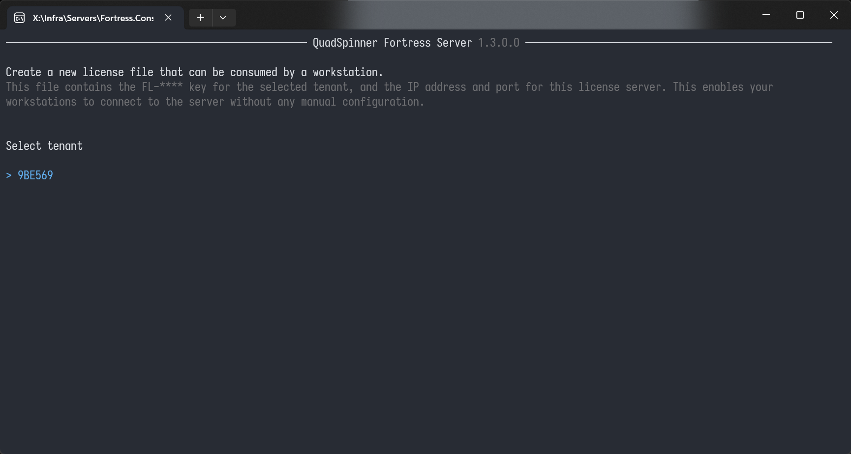

License File for Workstations
Use Create License File in the Fortress Console to generate a workstation license file.
A typical floating.lic looks like this:
FL-00000000-0000-0000-0000-000000000000
192.168.100.11:9000
  • Line 1: Floating license key
  • Line 2: Fortress server address and port
Create a License File
  1. Select Create a License File.
  2. Choose a Tenant.
  3. Choose the desired IP address (or enter one manually).
    • If the server has multiple network adapters, all assigned IP addresses will be listed.
  4. Choose where to save the file (or press Enter to accept the default path shown).
The file is typically saved as 000000.lic (or using the Tenant’s ID). Copy this file to the Gaea Data folder on the workstation and rename it to:
  • floating.lic
Gaea will detect floating.lic automatically and load both the license key and server connection details from it.

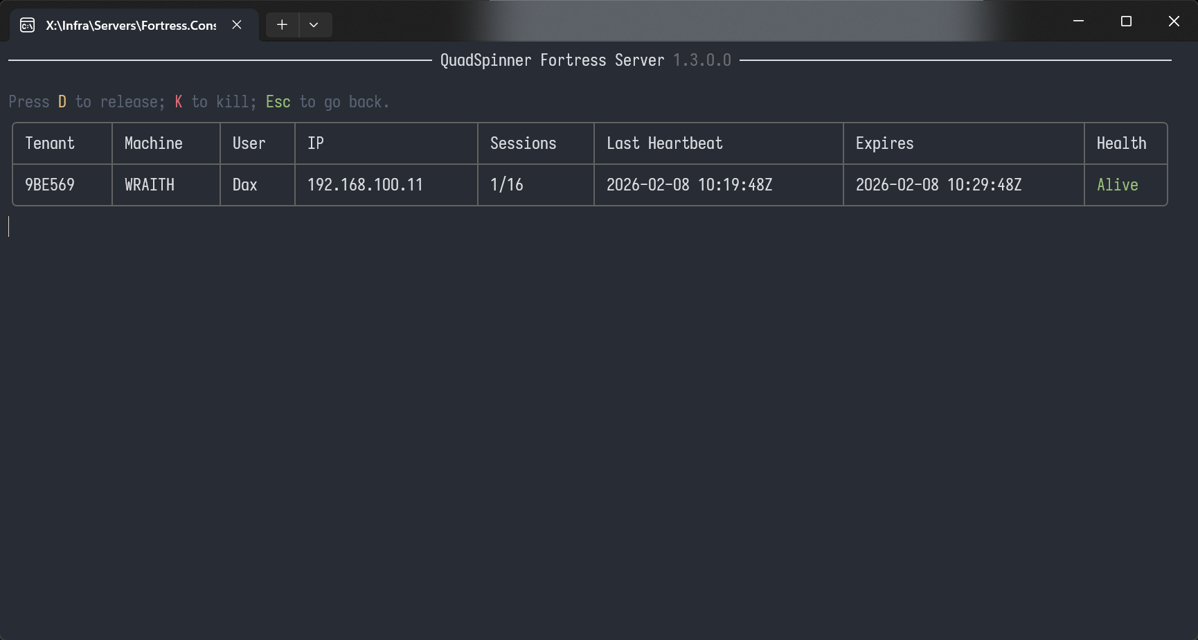

View and Deallocate License Tokens
By default, the Fortress Console shows only Tenants and does not auto-refresh to avoid unnecessary server load.
Select View Allocations to see a live list of allocated licenses.

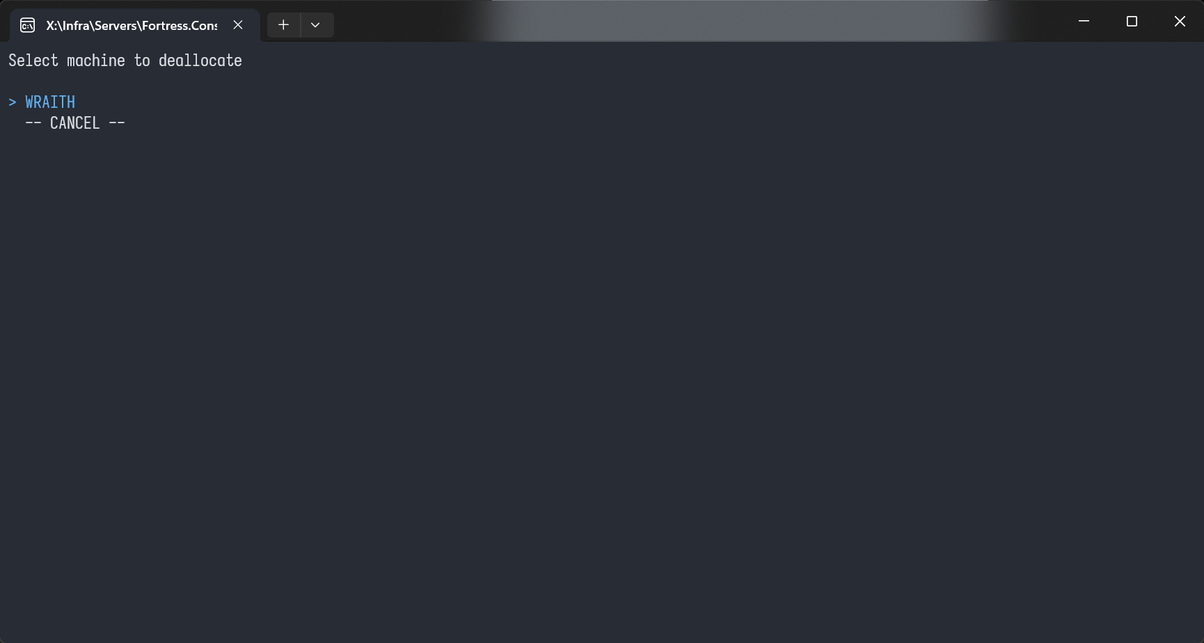

To deallocate a license, select the target machine. All sessions on that machine will be released.
Two deallocation options are available:
  • D (Graceful): Sends an "exit gracefully" command to the Gaea instance, then waits 10 seconds for it to be accepted and executed.
  • K (Force Kill): Immediately deallocates the workstation.
