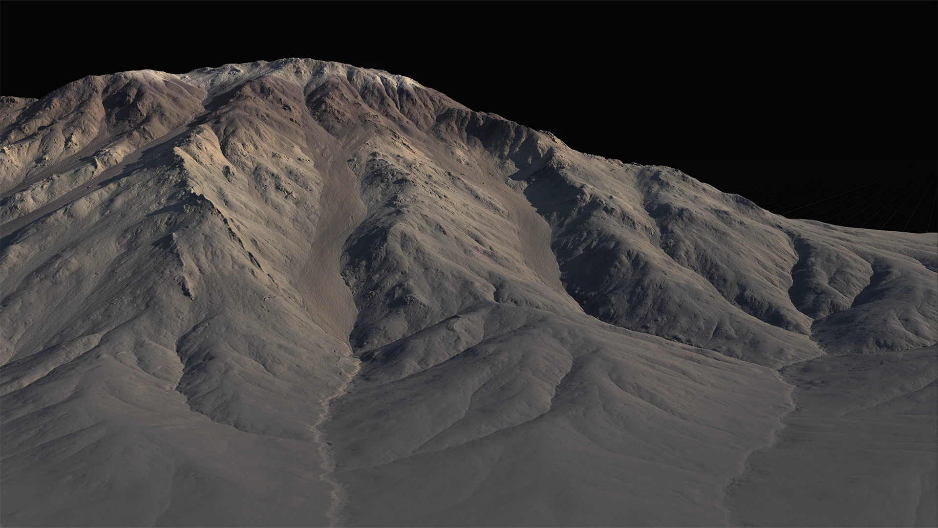

The Erosion_2 node in Gaea 2 is a powerful new erosion algorithm designed to enhance terrain shaping capabilities beyond the traditional Erosion.
Despite its complexity, Erosion_2 remains user-friendly and delivers deterministic results with up to 10x faster performance, even on the CPU.
It simulates advanced hydraulic erosion with realistic sediment transport and terrain reshaping. It offers fine control over downcutting, sediment deposition, and orographic (rainfall-driven) effects for highly detailed or stylized terrains.
Use Erosion2 when you want a more advanced hydraulic erosion pass with strong control over downcutting, sediment behavior, and rainfall-driven shaping.
