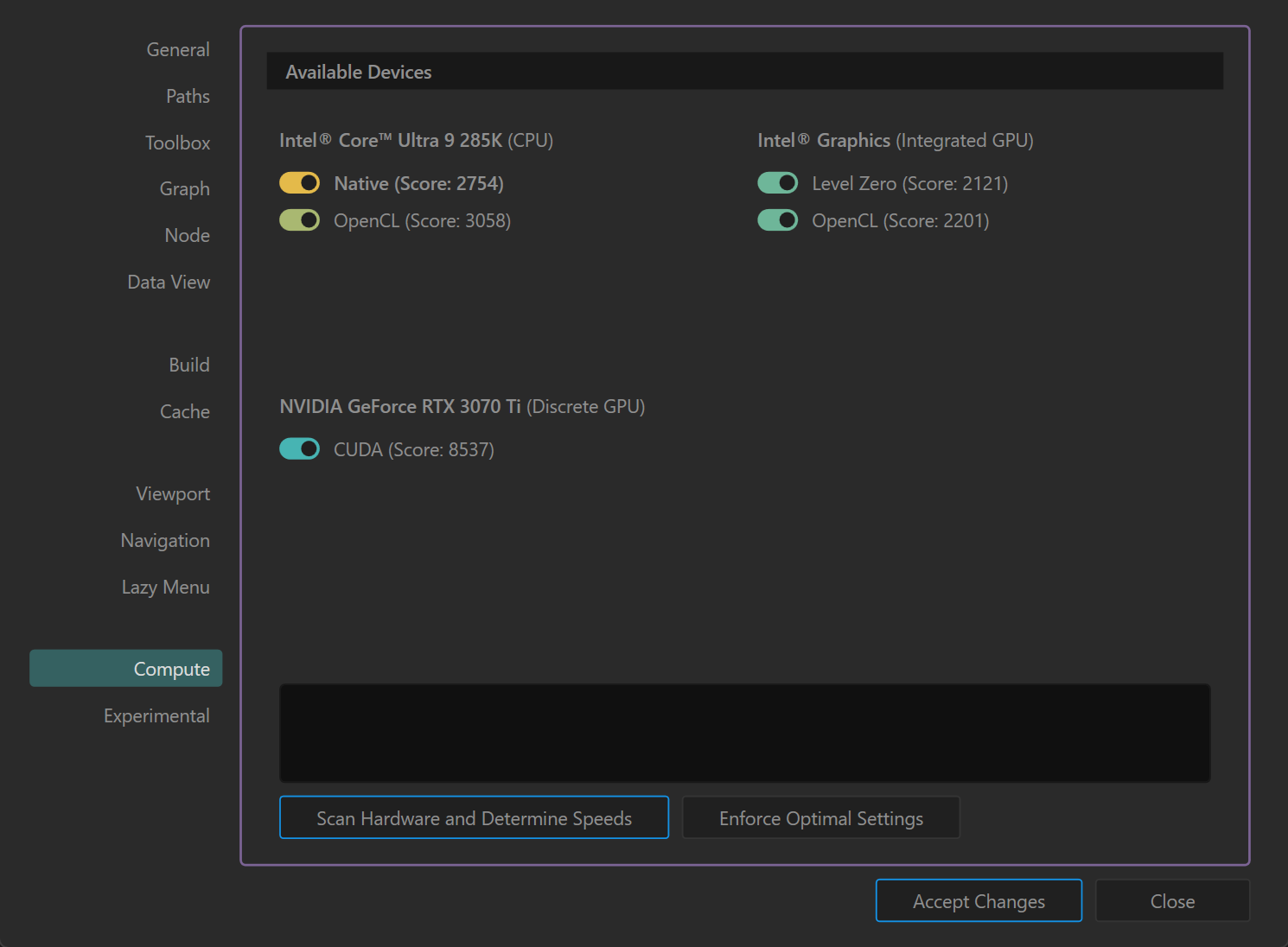

The Compute tab allows you to configure which available hardware devices are used for computation, optimizing performance across CPU and GPU resources.
Available Devices
This section lists all detected compute-capable devices and APIs, with a performance score indicating their relative speed in Gaea’s benchmarks (higher is better).
Device List
Lists all available computer devices that Gaea can use for processing terrains.
  • Sub-options under each device allow you to select which technology is enabled for that device. For example, OpenCL, Level Zero, CUDA, etc.
Scan Hardware and Determine Speeds: Initiates a scan of all hardware to evaluate processing capabilities and optimize device selection. Once done, a score for each device and technology is shown in the list.

  • Toggle Switches – Enable or disable each compute backend per device.
  • Score – Benchmark performance metric; helps you select the fastest option.
  • Scan Hardware and Determine Speeds – Detects devices and benchmarks their compute speeds.
  • Enforce Optimal Settings – Automatically selects the best-performing combination of devices based on benchmark results.
