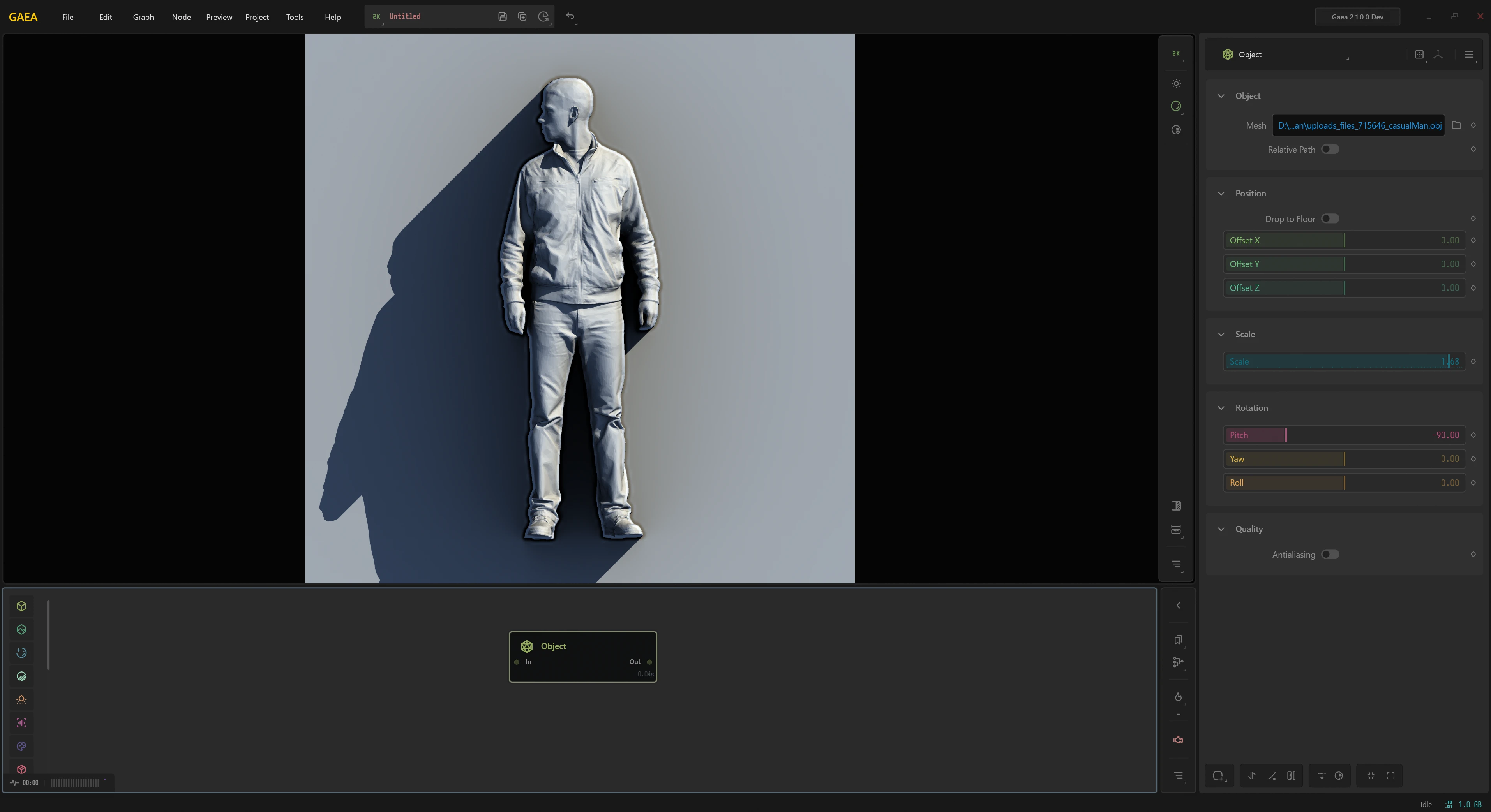

Gaea 2.1 introduces the Object node which can be used to import 3D models and rasterize them into heightfields. You can fully control the Scale, Rotation, and Movement of the imported mesh. The only limitation is that the 3D mesh is projected and rasterized into a 2.5D heightfield.
Once imported, the model will behave exactly like any other Gaea generated terrain, and you can do anything with it.
The Object node requires the original mesh to be present during build. If you are not going to have access to the mesh later, you may wish to Bake the Object node.
