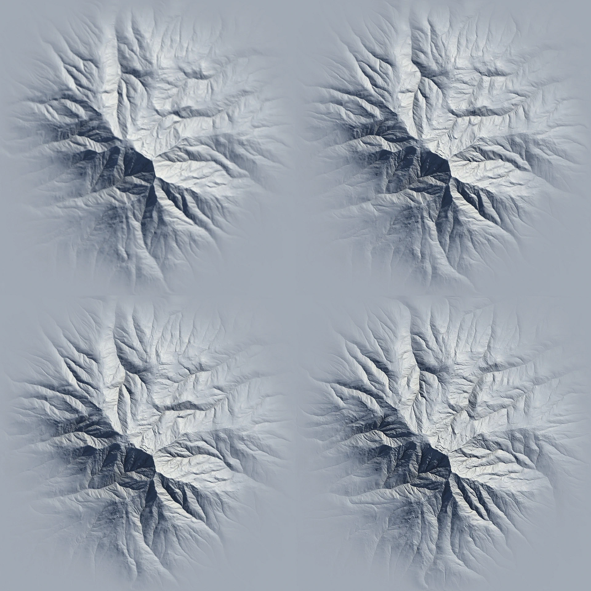

Determinism across 512, 1024, 2048, and 4096 resolutions.
Gaea's algorithms are optimized to reduce the difference across resolutions as much as possible, especially with Erosion_2, however depending on your terrain setup it may be unavoidable in some situations.
Some nodes like the classic Erosion provide a separate option to force Determinism by sacrificing processing speed.
Forcing Determinism
One of the best ways to ensure a specific shape, especially at an early stage in your graph, is by Baking Nodes at a resolution you like. Gaea will then upscale them at whatever final resolution you use and further low-yield Erosion or other effects can help compensate for the upscaling artifacts.
