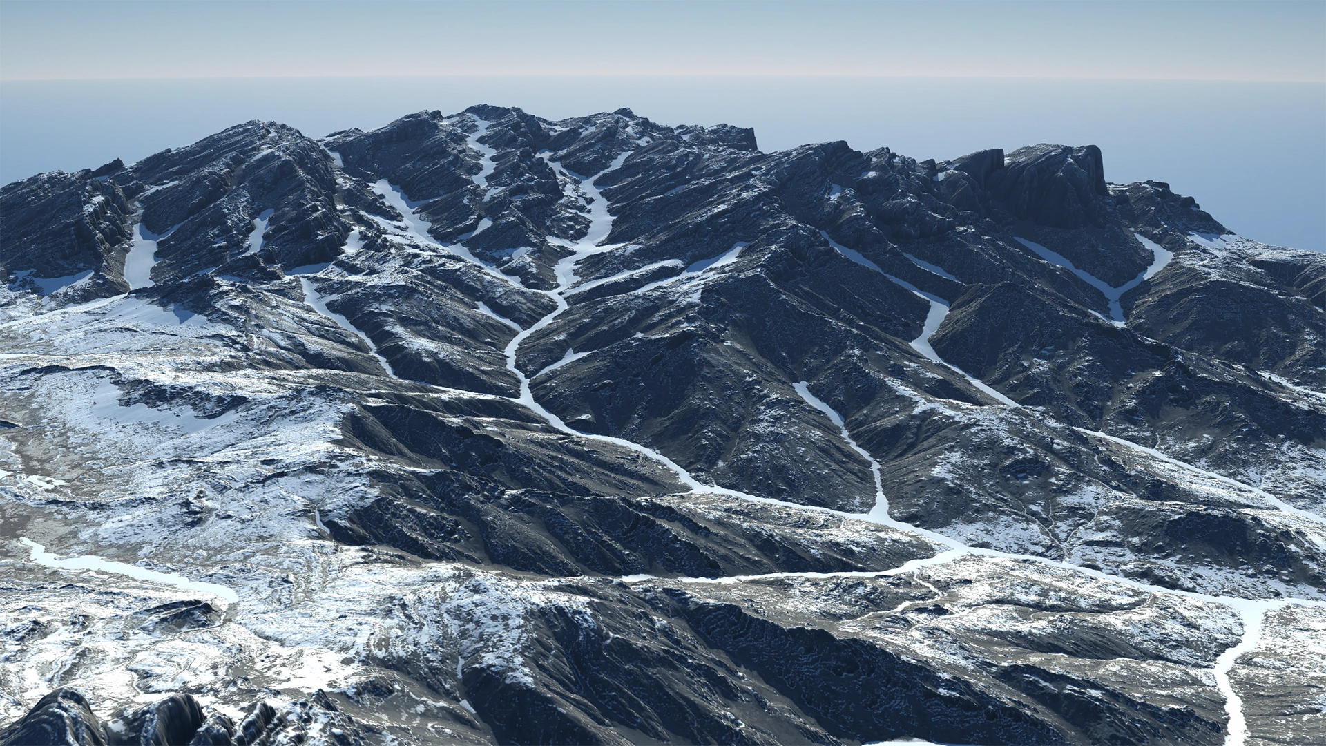

Erosion is the key simulation that helps you transform your terrain from a fractal noise or basic geometric shape (or even a complex shape) into a believable, realistic terrain.
Gaea's simulations of natural processes are the cornerstone of creating rich, believable digital terrains.
Creating simple erosion can give you great terrains, especially when powered by Erosion_2. However, you can take it several levels further. Creating multiple erosion passes and infusing different processes in between, lets you create very complex visuals.
