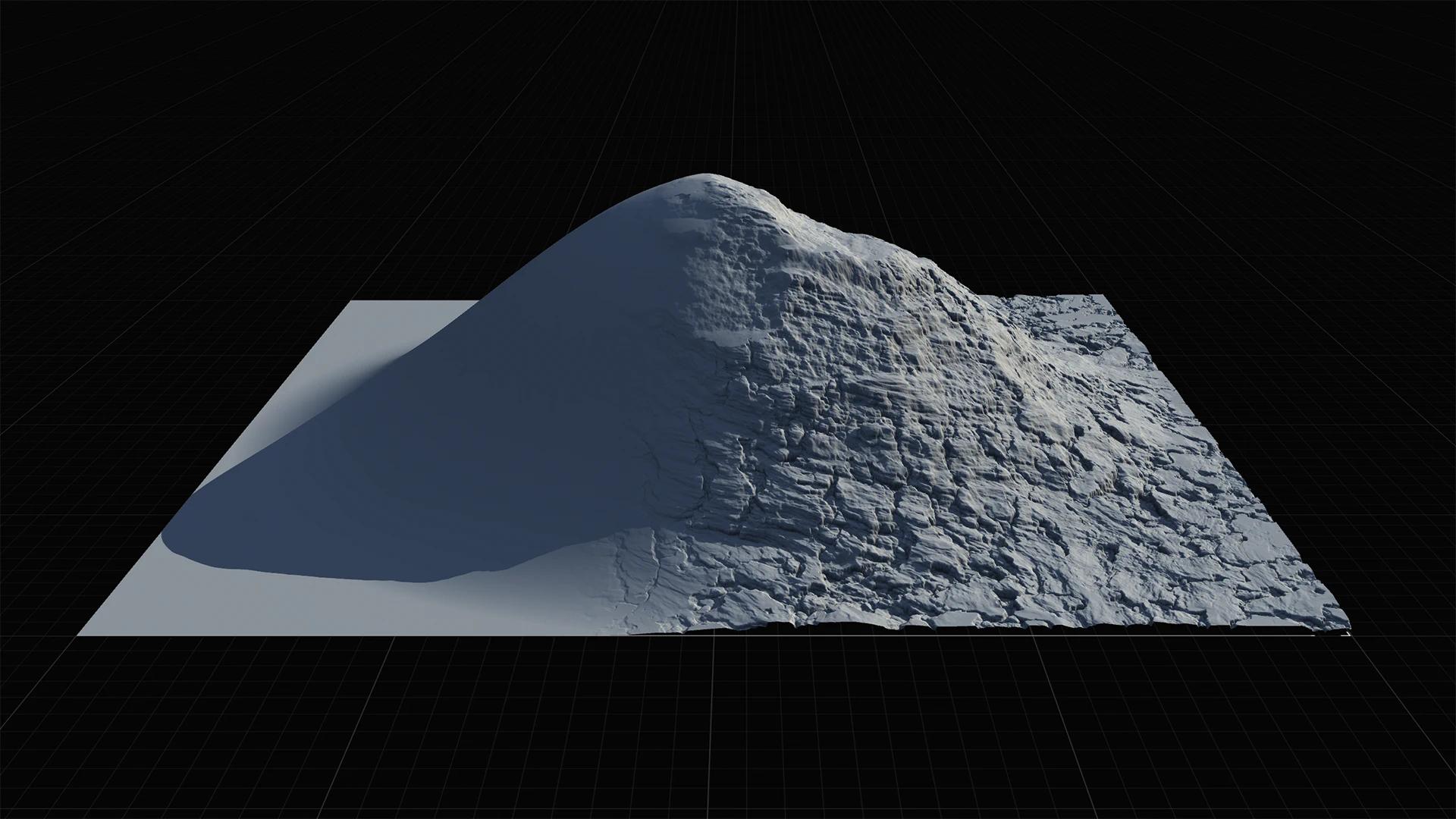

Gaea's Surface tools separate the process of designing the overall terrain shape (or volume) and designing the superficial shapes on the surface.
This allows you to modify the surface without altering the overall shape, volume, or silhouette of the terrain - which is crucial when you already have the asset in your scene yet need to modify it.

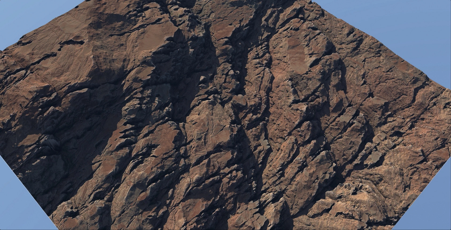

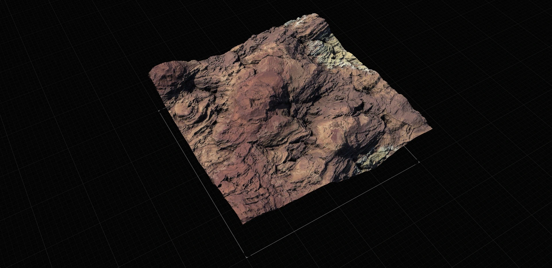

Stratify is a high-level node that provides large scale stratification, tilt, and uplift. It can be used for larger shaping.

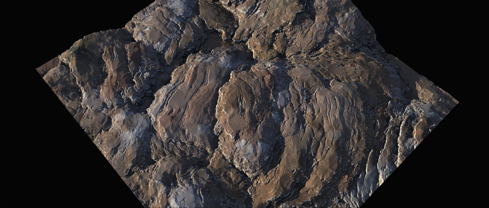

Sandstone is a versatile node that works on both small and medium scale to add multi-level detail through multiple passes while also chipping the rock and excising large chunks as mechanical erosion. Sandstone can also create staggered stairstep patterns quite common in nature. This pseudo-self-similar repetition is the hallmark of such rock formations.
FractalTerraces provides a more low-level approach to stratification and tilting, giving you more primary control. This is useful when you want to achieve direct control over the erosion through a complex graph and don't want Stratify or Sandstone to introduce too many features into your terrain directly.
Creating a complex rock formation such as the one pictured above is quite easy. You simply create a sequence of Stratify > Sandstone > Stratify > Sandstone, or even simply Stratify > Sandstone > Sandstone. Experiment with multiple passes for Sandstone and varying heights for each node.
If you want to add more breakup to your shapes, introduce Erosion or one of the Rock nodes before you apply stratification.

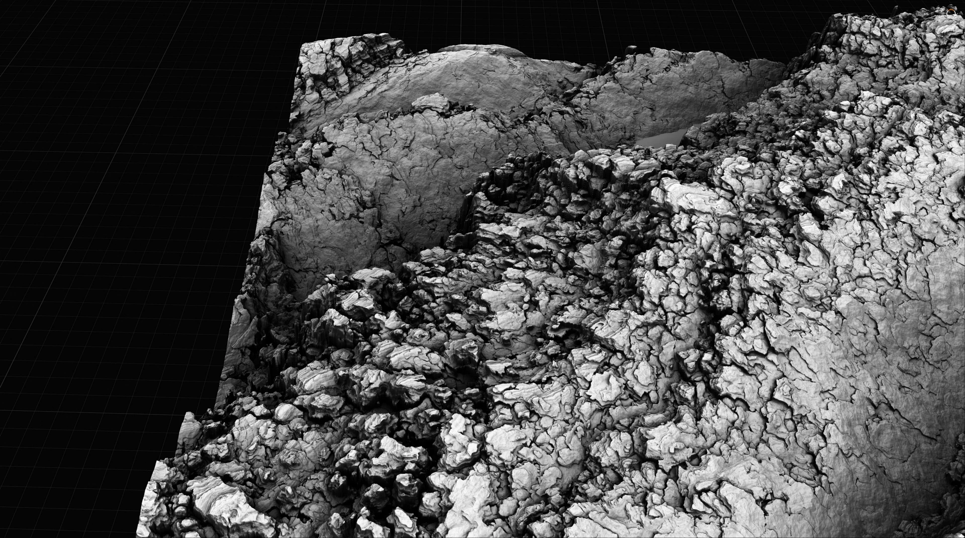

Outcrops can help you turn any surface into a powerful, rugged, large-scale rock formation.

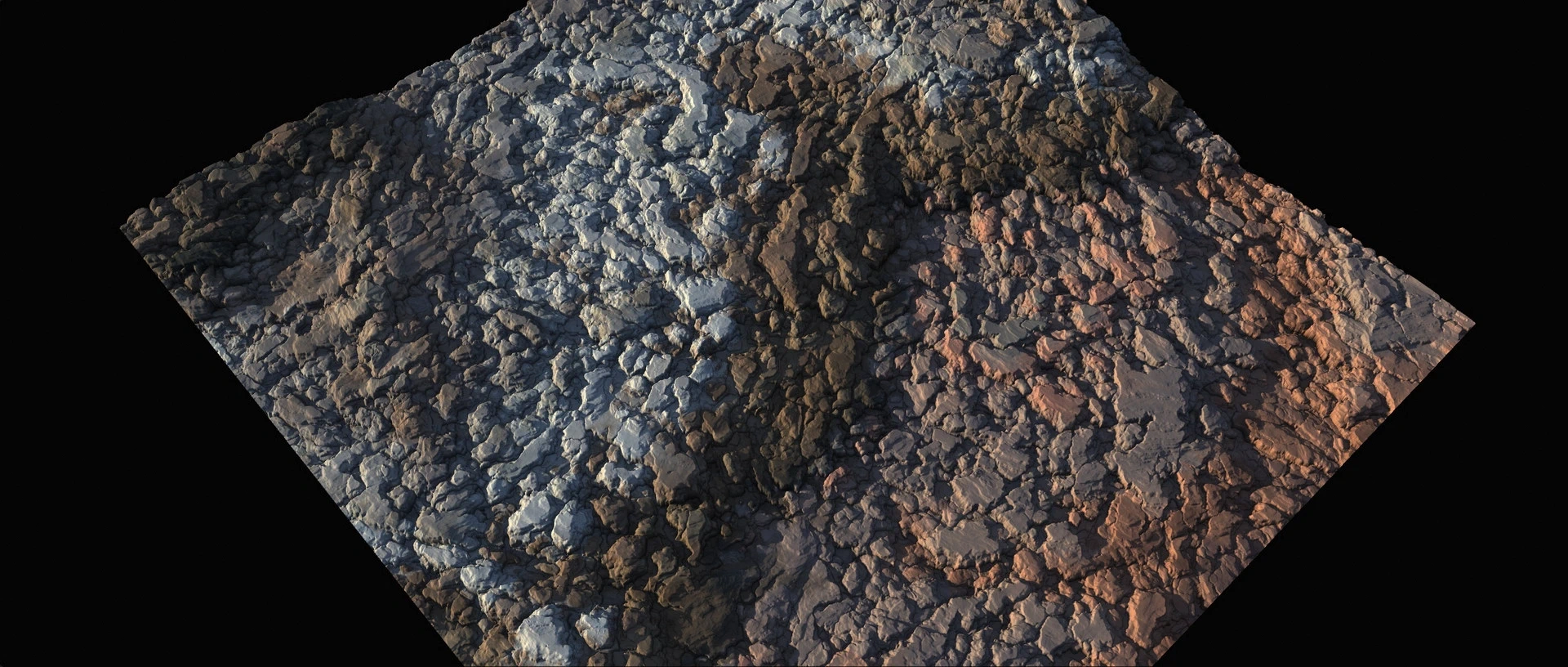

Craggy can help you turn any surface into a fragmented field of rocks.
