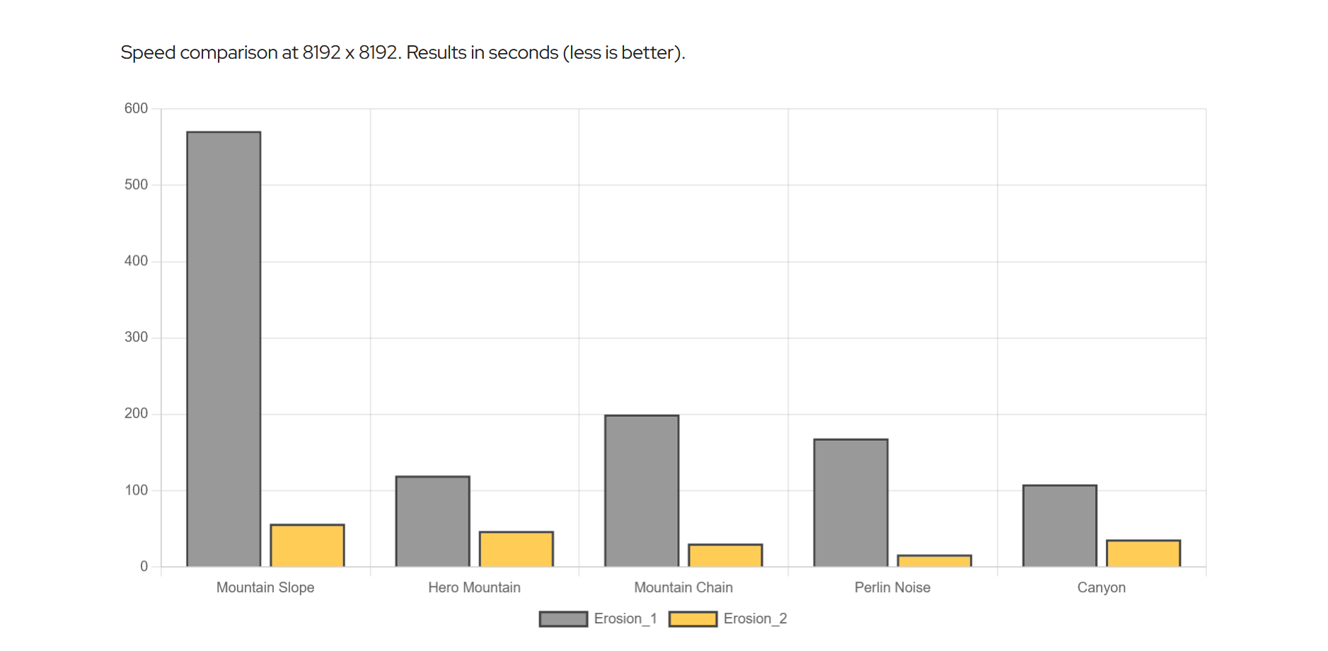

Faster Performance
Gaea's Erosion_2 can utilize either GPU or CPU. It has an intelligent fallback if your GPU runs out of VRAM then it will run the erosion on the CPU where it may be slightly slower but less likely to run of of memory.
In every scenario, Erosion_2 can outrun classic Erosion by several magnitudes.
