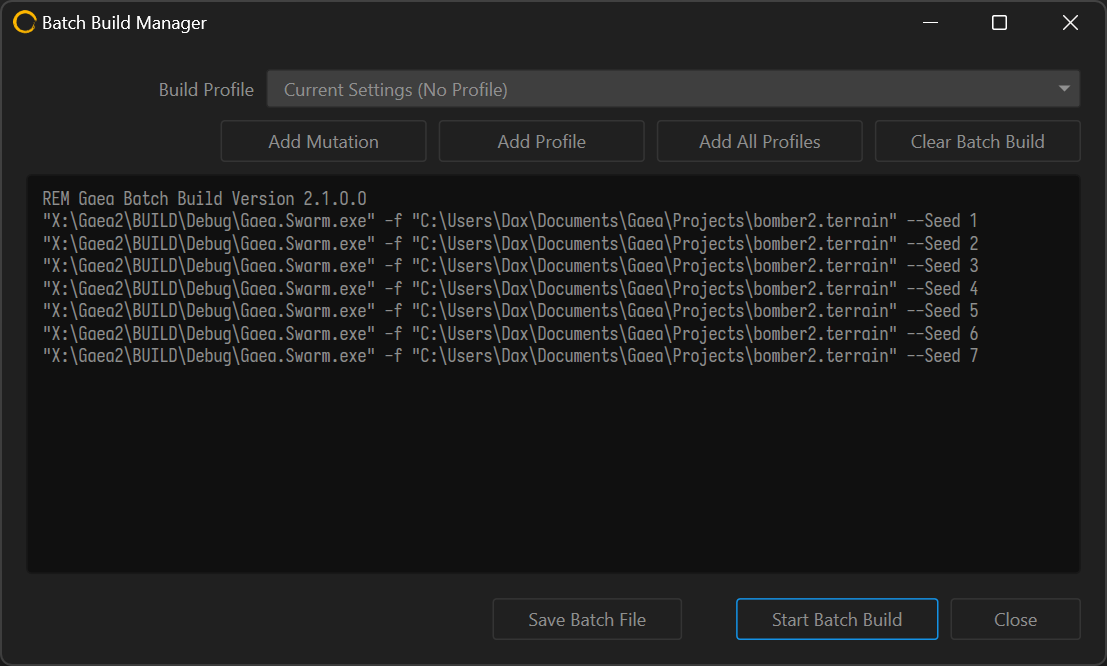

Using the Batch Build Manager
The fastest way to set up mutations, is to go to Build menu > Batch Build Manager and use the Add Mutation button to queue up as many mutations as you want.
If you find yourself repeating these builds, save the batch build as a Windows Batch (.bat) file.
Use the [Mutation] token in the Build Destination to add the current mutation as part of a folder name or subfolder.
For example:
<Builds>\[Filename]\[+++]\[Mutation]
or
<Builds>\[Filename]\[Region]_[Mutation]
