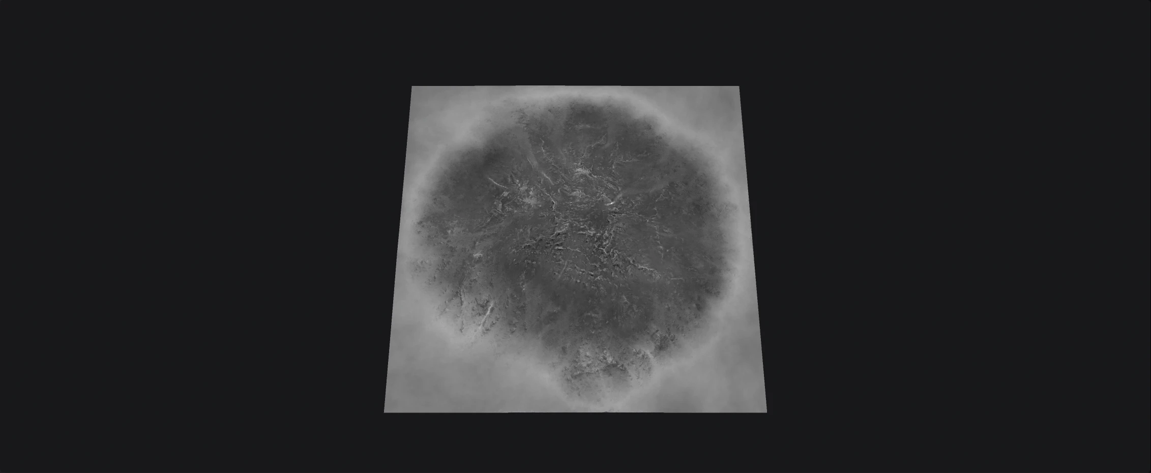

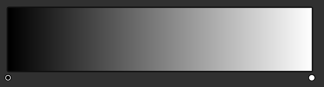

All color texture generation in Gaea relies on applying color ramps (gradients) through a black-and-white mask.

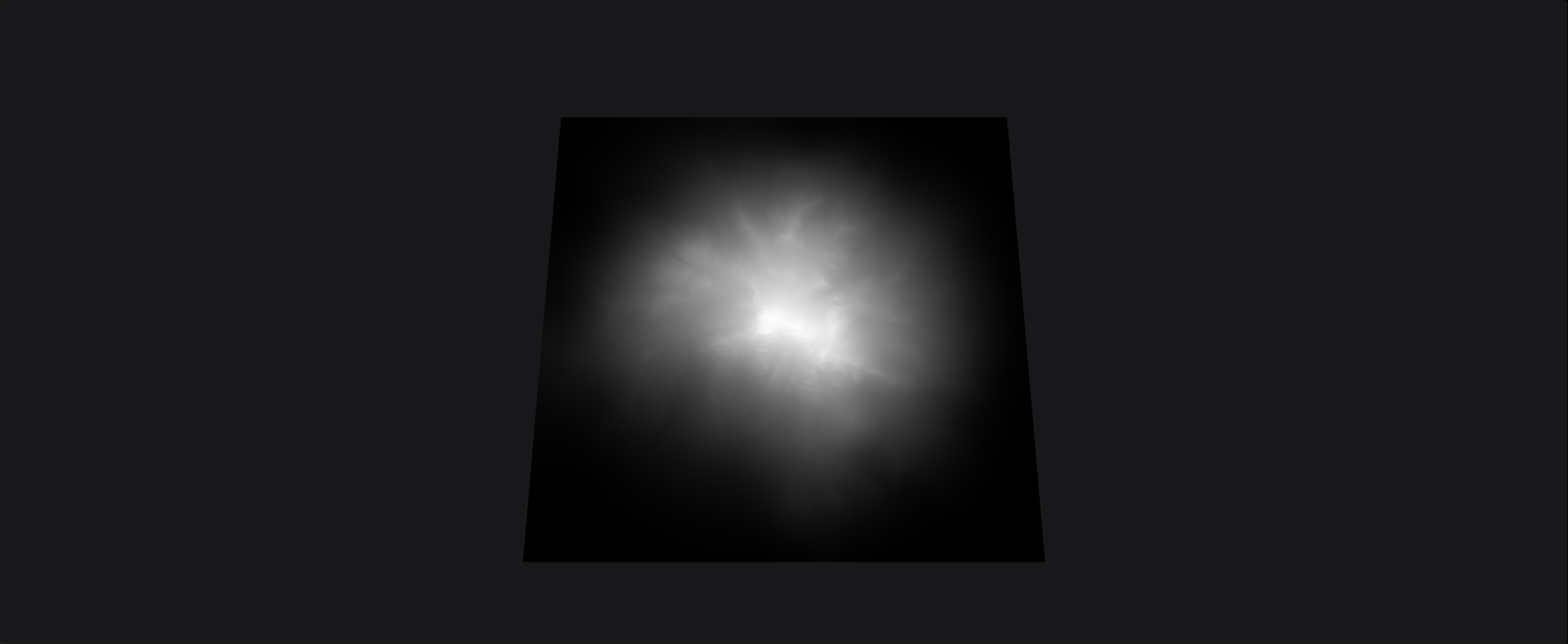

A simple example: the darkest part of the gradient maps to the lowest terrain elevations, while the brightest part maps to the highest. Intermediate grayscale values distribute the gradient proportionally. This is known as a CLUT or Color Look Up Table.
In this example, the gradient from a CLUTer node is mapped directly to the heightfield.

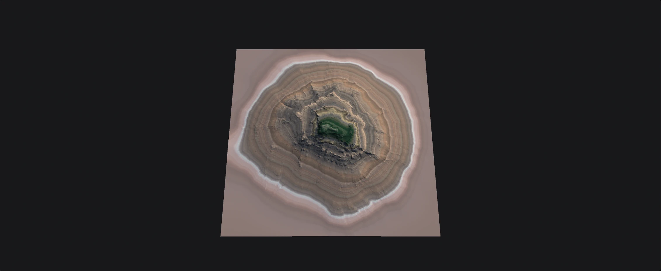

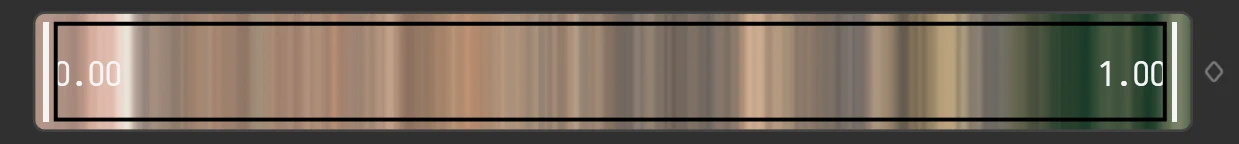

Now, let's a try more detailed, colorful gradient.
You can see how it distributes across the terrain.

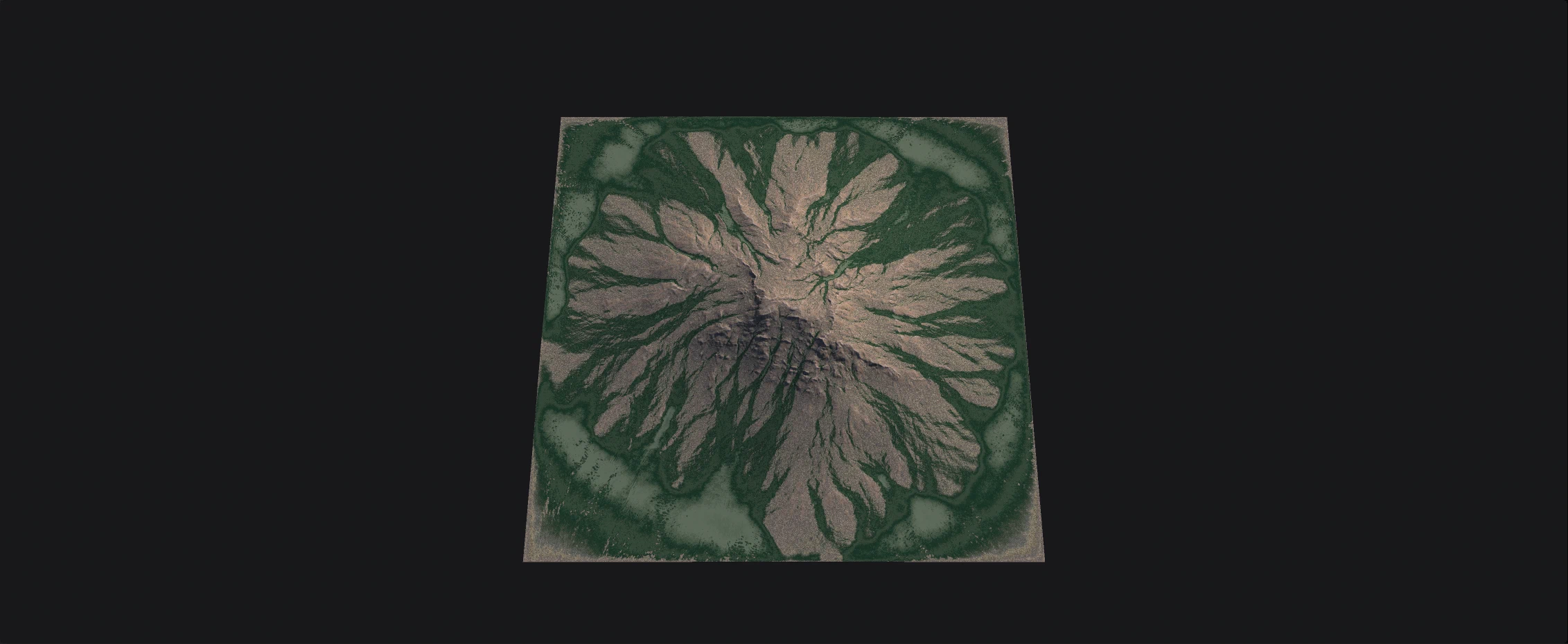

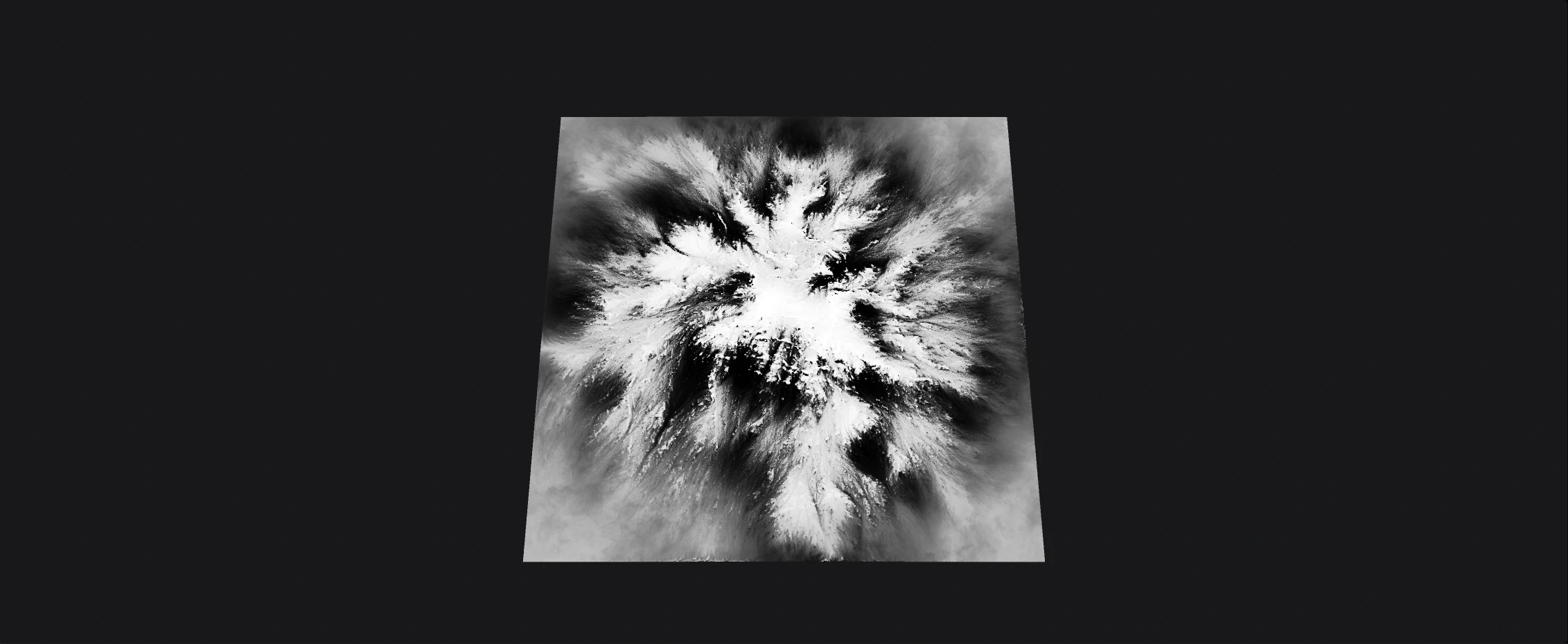

Now, if you use the same CLUT map but feed it a FlowMap instead of the terrain height, the texture will follow the flow lines defined by the FlowMap, producing a very different result.

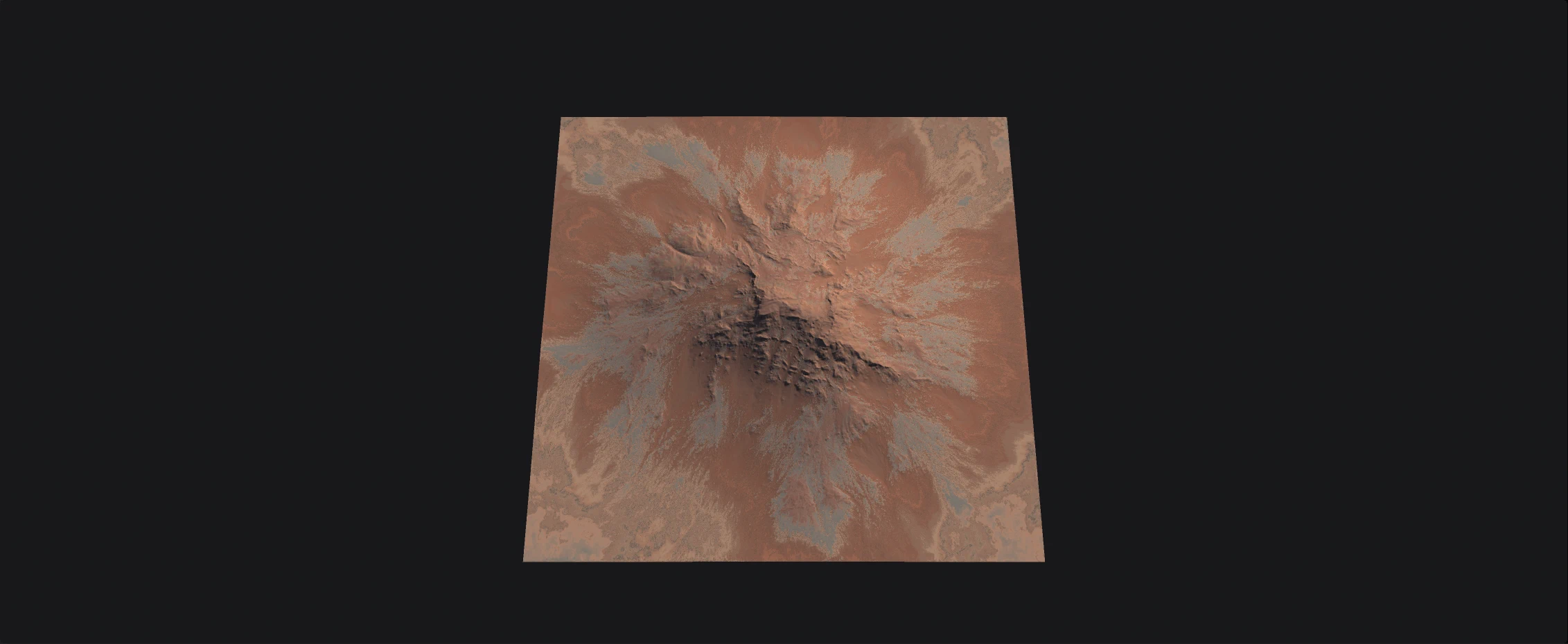

Which can create more complex textures such as this:

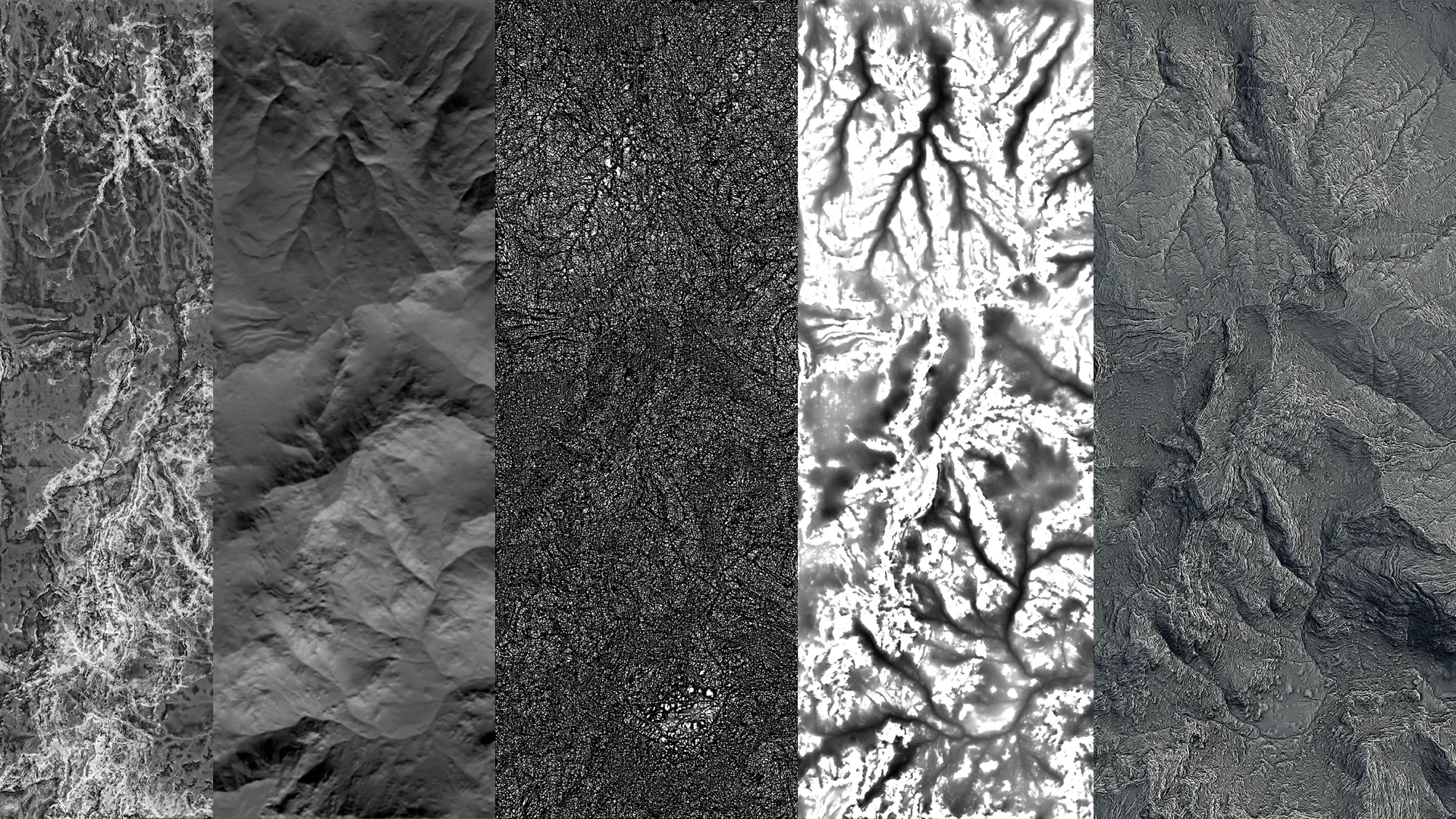

Aspect Maps
Aspect Data Maps mask out aspects of the terrain such as Height, Slope, Curvature, Angle, Peaks, etc.

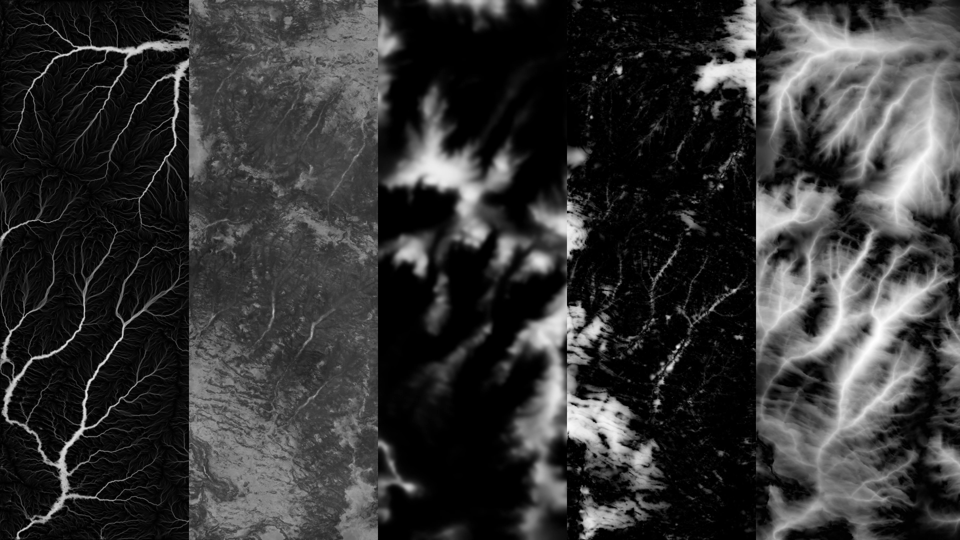

Generative Maps
Generate Data Maps run various algorithms on the terrain to generate information such as Flows, Soil, Rock Occlusion, etc.
