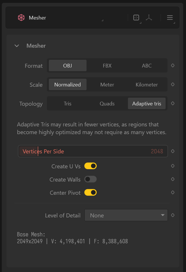

Mesh Output
Use the Mesher node to output the terrain as an OBJ or other support mesh.
Normalized Scale
As a best practice, export your mesh with Normalized scale. This means your terrain will be exported with a width of 1 unit, and height of proportional fraction of 1 unit.
Import the mesh into your target application such as Blender, 3dsmax, etc. then scale it by the same amount as the metric size of your terrain in Gaea's Terrain. For example, if your terrain's width is 5000 meters then you should scale up your model by 5000.
Depending on your target application, your OBJ importer may allow you to scale up straight in the importer by specifying a factor.
Real Scale
You can also export using Meters (1 unit = 1 meter) or Kilometers (1 unit = 1000 meters) and import without having to scale.

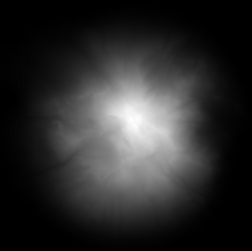

Displacement Output
Use Mark for Export, or Output nodes to save your terrain as a displacement map. 32-bit precision (eg EXR, TIFF) are recommended for maximum quality. You can also use 16-bit precision if you terrain does use too many dramatic slope changes, otherwise you will see stairstepping/quantization patterns.
