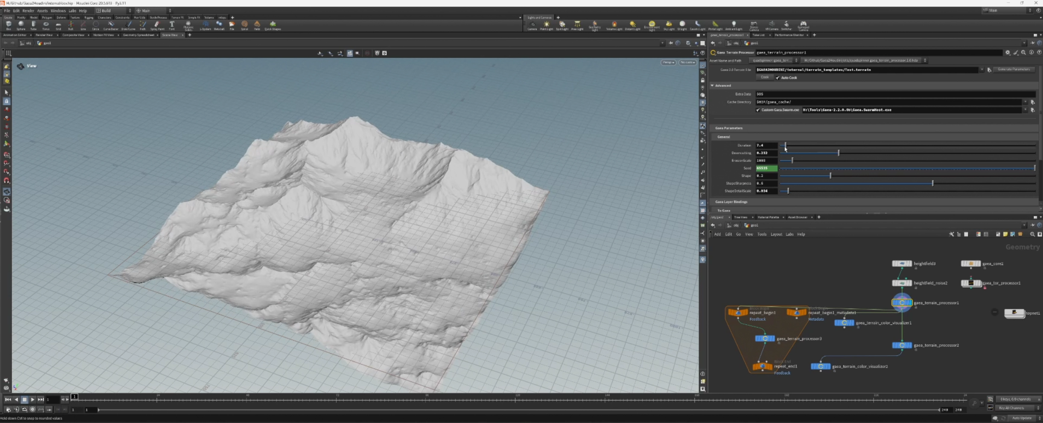

The Gaea2Houdini plugin enables you to access select Gaea simulations and tools natively inside Houdini as standard Houdini nodes.
Infuse your Houdini worlds with Gaea's 180+ nodes.

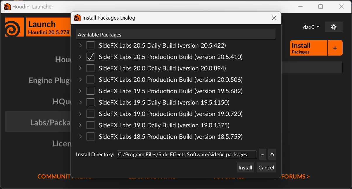

Install Gaea2Houdini
Gaea2Houdini ships in SideFX Labs and can be installed directly from the Houdini Launcher.
You can find further details on SideFX Labs' Installation process in their documentation.
Choose the Daily Build to install the version with the Gaea2Houdini plugin, until it is made available in the Production Build.
